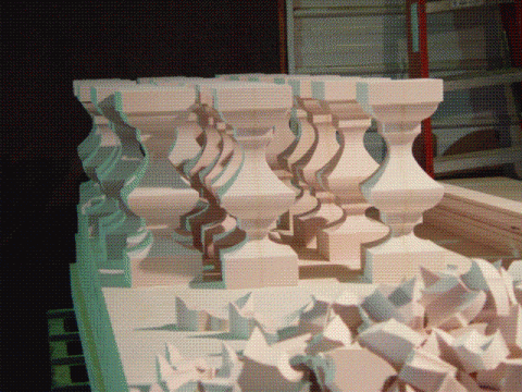

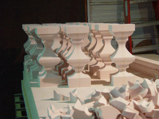

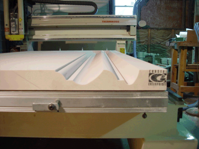

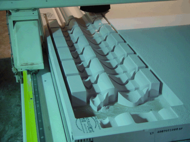

Daniel Vonderheide
- Posts: 361
- Joined: Wed, May 17 2006, 11:25AM
- Location: Thermwood
Re: Discusion on profile modeler
here's some of Will's work done with PM and dxf files. There's alot more pics, but I have to resize them first.
