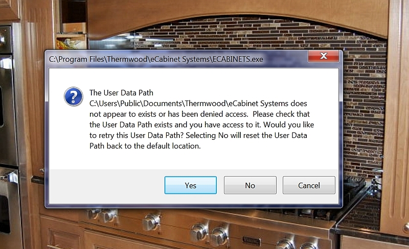

I tried to open my Ecabs last night and got this --
Then when I clicked -- No -- my Ecabs opened and I had no cabs or anything else in the file.
It's not a big problem as I have a copy on my other hard drive but can anyone tell me how and why this happened. I don't know how much info I have really lost.

Re: Lost Info
Wally,
Have you tried resetting the user data path via Settings and Preferences? If not, please try and do so by selecting browse and choose the path. Try this even if the path is already set to what you would expect.

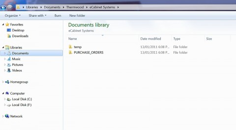

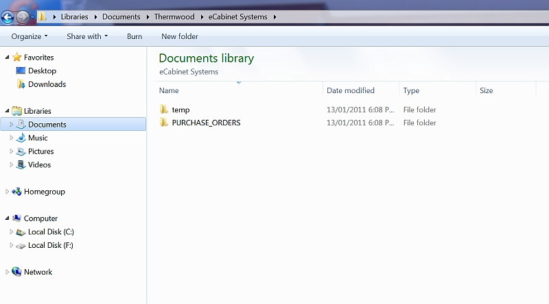

Scott - When I go through the steps and get to where the files should be there is nothing there.

Re: Lost Info
Use the full path instead of the Libraries link. Start at C: then open "users" followed by "public" then "documents", "thermwood" and finally "ecabinet systems."
The Windows libraries don't show "public" folders unless you specifically add them to the library.

Re: Lost Info

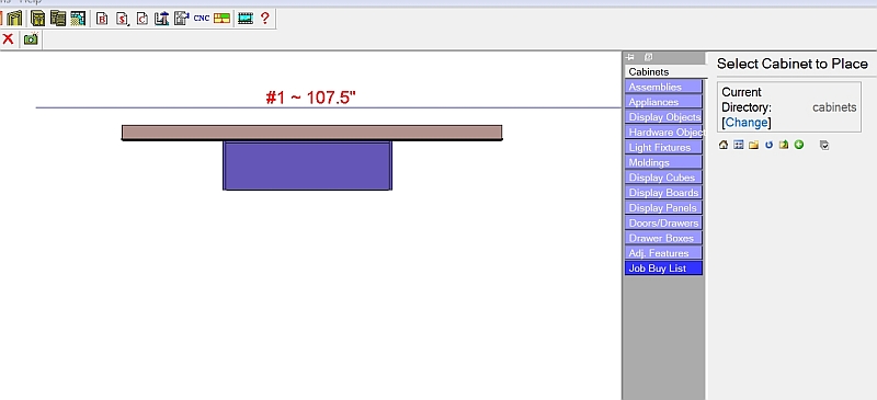

Thanks Scott & Dan -- I have tried both of your suggestions and there was nothing there. I do get standard cabs when I open the program now but I have lost all my V6 cabs and drawer boxes. It's not a big deal but I still am wondering how this could happen. I save all my jobs to the other HD so I do have a copy of most of the cabs I created in V6. I have reinstalled V6 on C drive and copied some folders over from D drive. Thanks for your replies.
