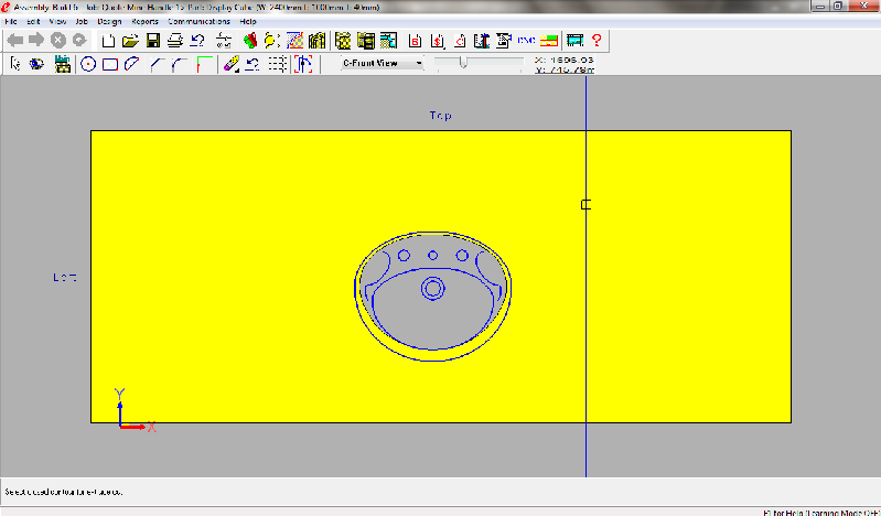

Just so that I am clear, would the attached DXF have that problem?
I can see 16 segments but it looks as smooth as an arc.
Also, I know I'm not half the craftsman most of you are here, but whats the down side to having a slightly messy cut underneath bowl? Ours get done freehand with a jigsaw.
Is it the machine time involved?

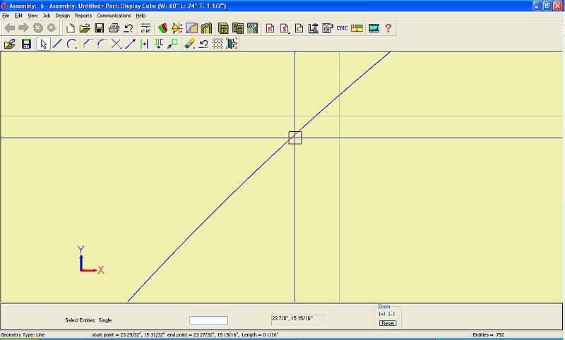

George,
Here is a .dxf I created in DeltaCad. The picture is of one segment after I import that .dxf into eCabinets. As you can see there would be thousands of segments to make the oval. (the red line in the pick box) This really bogs down the Part editor.
Bryan has the same thing in the outer circle of his .dxf. The inner circle he is cutting is only sixteen segments which is fine but the outer is a great number of segments.

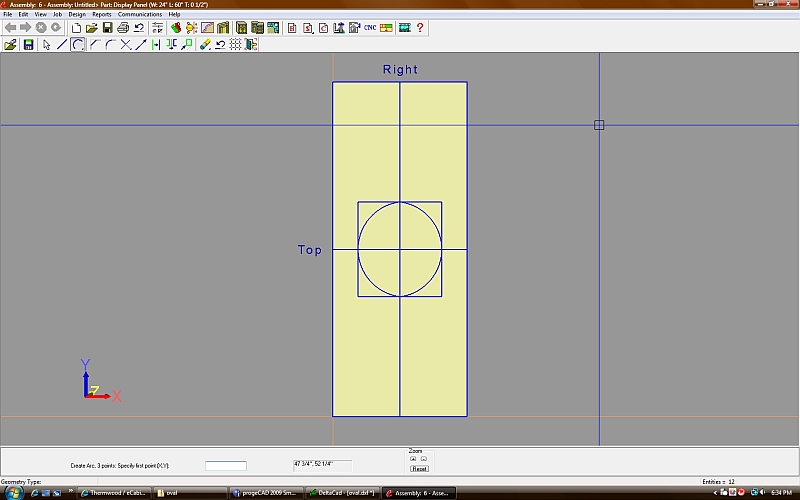

- Gary Puckett
- Posts: 1324
- Joined: Mon, May 19 2008, 1:39PM
- Company Name: The Woodworkery
- Location: Saint Charles, Missouri
Re: Profiling a oval shape
Kerry,
Why not just make a square 17 x 15 and use the three point circle.
