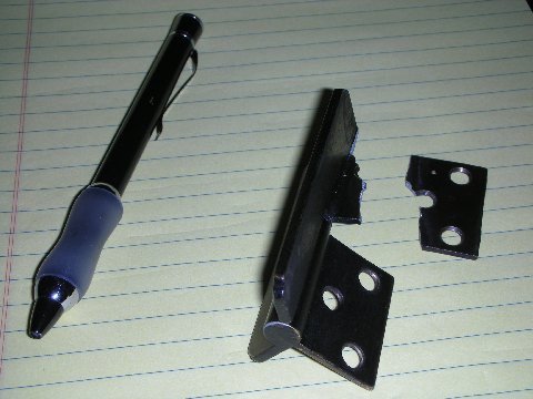

I have a broken hinge on this Armoire that is about 40 years old. It is part of a bedroom set made by the furniture company Century. I am told that you can not contact Century but have to go through a dealership. I have not been succesful with that avenue. Has anyone seen such a hinge or know how I go about getting a replacement. I do not think it is real brass - just brass antique finish. I was told this is probably a custom hinge by Century. There is very little magnetic pull on the metal. I was told it may be "pot" metal. Reason for breakage seems to be no lubrication and the hinge pin seized. Yes - that's right - I never lubricated my bedroom set hinges in 40 years. (My Bad) I have searched all over the internet and can't find anything that is even close. Maybe someone makes custom replacements?
Showing back side of hinge. 3 screws to the mortised door and 3 to the cabinet.

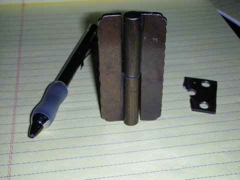

broken hinge 2.jpg (33.55 KiB) Viewed 53757 times
Showing how hinge is shown with closed doors

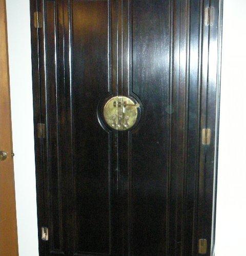

Picture of Armoire
Picture of Armoire

That is an unusual hinge Dennis. Is it a lift-off hinge?
You might try Ball & Ball or Whitechapel to see if they can make one for you. You might want to replace all of the existing hinges if you can get them made. Of course once you get the price for a one-off custom hinge you may decide to just use duct tape! :joker:

I hate to replace them all because it is the same hinge on my Wife's dressor. It's just a door hinge. The two parts that fasten on are hidden. 3 of the screws fasten onto the edge of the door and fit into hinge pockets. The part that fastens to the edge of the cabinet - just fastens onto a flush surface.
All these years I thought they were brass hinges. I was a little shocked to see they were (probably) "pot" metal. Pretty sure they are not brazeable or weldable - or I would take a chance at fixing it myself. It may be that the remaining two hinges on the door will do enough to bear the load and maybe I can just put this broken one back on for "looks". I'm 61 now and plan to live at least another 45 years. Maybe if I can get through another 40 years - I will replace all the hinges and turn the furniture over to my kids. I've always been proud of our Century and Henredon Furniture - but this POT METAL thing has thrown me for a loop. I wouldn't even expect that on some Chinese import. :wall:

What I mean by lift-off is that the hinge allows you to lift-off the door without removing the hinges. That is, the top of the hinge comes off the bottom part. It looks like the bottom knuckle has a pin that extends into the barrel of the upper knuckle.
If this is the case you might be able to replace the blades with a hidden hinge and just stick (did I say glue?) the decorative part onto the outside of the door (or even to the knuckle of the "new" hinge). To do this you would probably have to remove material on the back side of the knuckle so it would just be a shell that sits on top of the replacement hinge knuckle.

Denis, do you think the hinge can be repaired? Like welded? It look like the seam left from the weld won't show and hopefully it'll be strong enough given that you put some W40 from time to time.

Dan - yes they are lift off hinges, however the manufacturer chose to put two lefts and one right on one side and the opposite on the other so the doors can not be lifted off. I think that by putting at least one of the hinges on upside down - is what caused some gauling and seazing of the pin. I suppose I could change that since there are 3 lefts and 3 rights and do as you suggest.

That's definitely cast ("pot") metal. It can't be welded, it'll just disintegrate.
I think Dan's onto something, there. Find a hinge that you can conceal behind the original one.
I'm tempted to suggest trying some of that "steel" epoxy putty to glue the parts back together, but I don't know if that would work, because there just isn't much surface there...not to mention, that stuff rarely lives up to its sometimes ridiculous claims. :wink:

Georgi, From my past experience, I have never been successful welding "pot metal". Maybe it can be done - but The doors are actually opening and closeing really good right now with just two hinges. I'll give Robb & Stucky a little more time to try to locate - then maybe try putting the broken hinge back on - just for looks ??(with some epoxy)?? I just don't want my kids to think (in the year 2055) when they inherit this furniture - "Oh man, look what Dad did - he jury rigged this hinge"!!! :oops:

Why not just take the one off the other side that is not doing every thing and swap it out?

Will Williamson wrote:Why not just take the one off the other side that is not doing every thing and swap it out?
Along this line of thought...you might want to move a center hinge to the bottom position to relieve stress on that door.

Good ideas - I could replace this bottom left hing with one off the center of the door. I was thinking of doing away with the broken (3 screw hole section) and use a couple small brass counter sunk screws through the hinge face and through the door instead - then file off the head of the screw driver slot flush and put a little stain on the screw heads. :idea:
