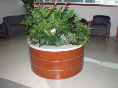

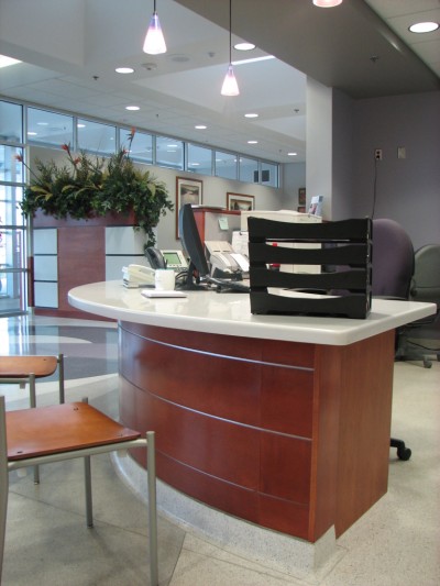

Honestly,I love e-cabs,but radius work is tough to do in e-cabs.
Your really have to build your parts in part editor, starting with a display panel. This will give you something that will machine.
If your looking for something to render, I would use another approach sac as cabinets,etc.
I will attach a couple pictures of easier radius work that was done in e-cabs using display parts.
Hope this helps
