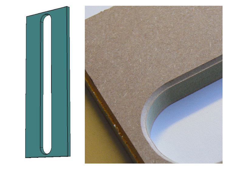

Hi
This part has been made in the part editor and we have a problem with the tool offset, the part was made with no offset but after machining it is offsetting into the part 1mm.
I have emailed program@thermwood twd,export,cnc files.
Thanks Stephen

Stephen,
We have received some of your files, however, we will also need to see the shape manager data which would be saved as the .x_t file.

Ryan
We have just relized that the point of the tool has been damaged. :oops:
Thanks Stephen

Re: Offset problem
Post by Ryan Hochgesang »
Thanks for the update! It is easy to sometimes overlook the obvious :)
