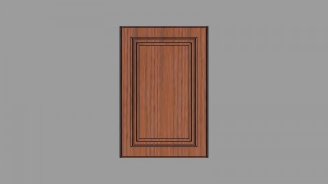

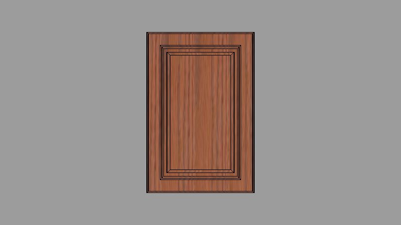

Scott,
This is a door created from a cabinet with everything deleted but the back. I created three tool paths and cut pockets. I can now contrain the tool paths and re-size the door in batch to nest them.

Have you cut this door using 3 cutters or are you modling? The dxf file I cut using pockets I used a 1.5 cutter for the panel raise,a .875 cutter for the bead on rails and stiles,a .125 cutter to square the corners. The pockets were 5/16wide,3/16wide,3/32wide.I adjusted the dia. for each cutter.

Scott,
I was wrong, they won't profile in the nest. You should be able to assign a custom tool to each cutting region in the profile modeler but then you are back to doing one door at a time.
I will have to try it next time I am at the machine. (I am cutting on another shop's machine which is 90 miles away)
I just started learning Paneletrix software this morning. This is probably still the best bet for producing mdf doors.

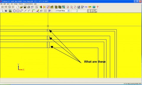

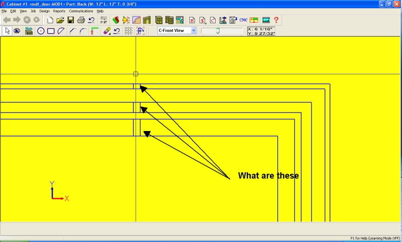

Scott,
I don't think you can have two paths following the exact geometry, you would have to offset them a little. eCabinets won't select one path on top of another.

Scott,
I tried offsetting the tool paths slightly and that worked in eCabinet. (you could use too offsets to counteract the paths if you needed to) I think this would allow you to choose the different regions in the profile modeler and assign a custom tool. I am not sure how much of a time savings this would be because you would still be doing one door at a time.
