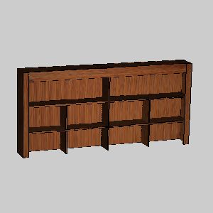

I know I'm doing something wrong - I just can't figure out what. I'm trying to add a left-right stretcher with up-down orientation to this cabinet. It keeps telling me the dimensions are unworkable for this cabinet. I need to add a stretcher at the top as a nailer to hold this beast to the wall. It will be made from the same hickory sheet goods.
Can anyone tell me what I am missing with this? TIA

Posts: 846
Location: Newport, WA
Re: Suggestion
Post by Donald Thomson »
I have to apologize. I had clicked on start a new topic for the previous posting and somehow it got placed in this thread. I'm not intentionally trying to hijack the thread. Any way to move it?
