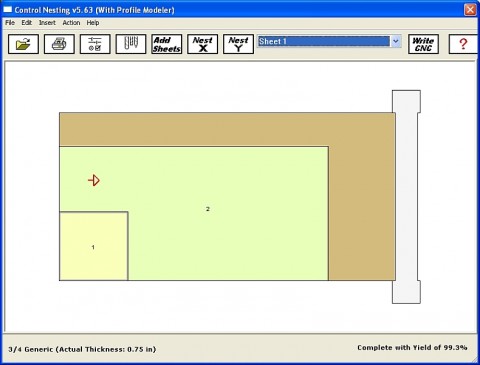

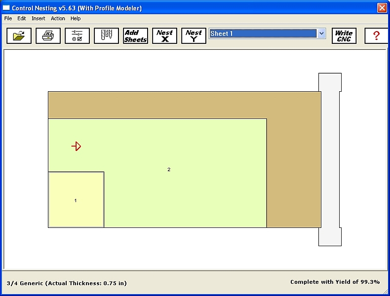

The carving name and information is in the twd file. The actual carving nc file must be stored on the controller before Control Nesting can use it. You do not see the actual carving on the piece in CN either. You see a small arrow indicatinig that the carving is located there. In the code, CN sets the scalling and all of the other information for the carving and then passes that onto the carving file.
Daniel Vonderheide
Posts: 361
Re: Help with Inset, Applied and Furniture Carvings
Post by Daniel Vonderheide »
Here is the actual information that is put in the code and a pic of what the CN screen looks like with a carving applied.
Thanks Daniel,
That tells me what I needed to know. I was confused because when I nested the part with the carving there were only 202 lines of code. I didn't see the call for the carving. The arrow for the carving was also showing up on my off-fall instead of the part
but I discovered that was because I had Flip Ops first selected.

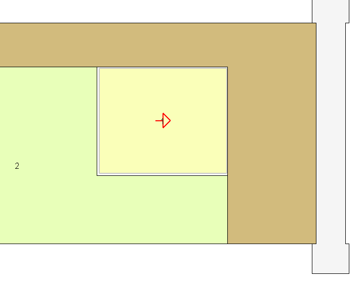

Daniel,
One other issue.
If I try to nest this part with a carving created using a Display Panel it completely locks up Control Nesting. I can't even open the Task Manager, have to do a hard shutdown on the computer.
I have attached the part and the twd I created.
