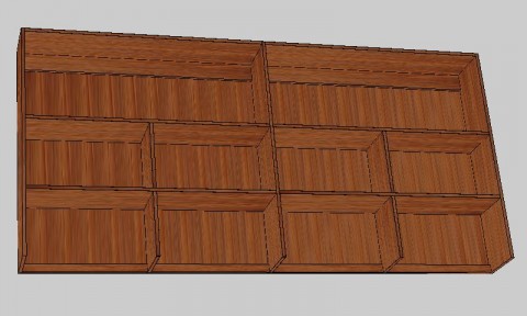

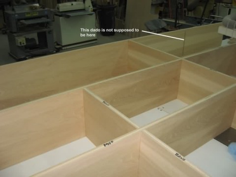

I'm not sure if this is an eCabinets problem or ShopBot Link problem. I've attached a cabinet I'm trying to make along with pictures of the results of the cutting operations.
The top shelves (very top of the cabinet) are not supposed to have any dados cut per photo rendering picture attached. But the results clearly show that a dado was cut in the top right shelf but not the top left shelf.

This is how it's supposed to be
Results from cutting operation

I nested from the cabinet editor and there is no operation on the part "right side top shelf" that would create a dado in the middle of the part. Is it possible that someone assembled the cabinet incorrectly, or perhaps made a mistake with labeling parts? TWD will likely ask you for a CN export file and the .twd file to be sure. I can't do anything with either of those files, but I can say that the cabinet in your job file appears to be correct.

Yes the cabinet is assembled properly (I'm the only one in the shop so another "employee" didn't make assembly mistakes). I've got the supporting files and I'm ready to send them to Thermwood when they are ready.

Any chance that one of your employees that wasnt paying attention ( :joker: ) placed the wrong part down for a flipOp? That would result in an extra dado. One of my "employees" put a wrong label on once with a similar result.
