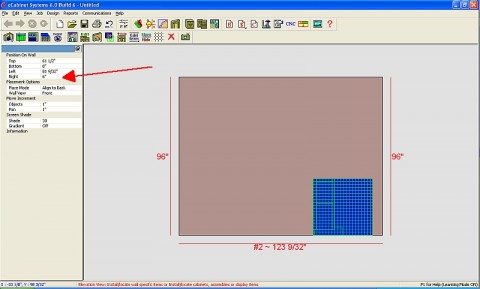

Heath,
This has the appearance of a bug or an oversight> (Or it could be by design. Corner cabinets seem to play by their own rules)
To get you by:
If you will snap your corner cabinet to one of the walls away from the corner it will snap the 6" away from the wall.
Now go to that wall elevation view and click the cabinet to select it.
If it needs to be 6" from the right corner simply enter 6" in the right corner numerical entry box under Position on Wall
the cabinet will move into place.
You can also use formulas in these boxes to move cabinets.
If your cabinet is 69 9/32 from the left wall and you want to move it 48" just click after the 69 9/32 in the entry box and type in + or - 48" to move it the direction you want. (make sure you eliminate the " sign before typing the rest of your formula.

Kerry,
Thanks!
I guess I didn't realize that it would offset correctly in one direction... just not both. I simply wasn't giving the software time to react to my furious mouse movements!
I was able to successfully duplicate exactly what you suggested and it worked great. That saves me from having to enter in the dimensional information twice as I was doing (I was placing it in the corner and then going to both elevations and changing the dimension).
I still may put a hidden stretcher on the back though so it's easy for our salespeople to place these items.
