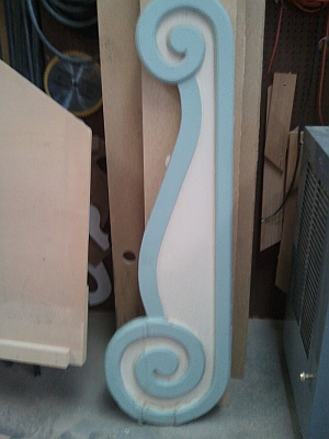

Here is a shutter I needed to reproduce.
Picture 004.jpg (96.42 KiB) Viewed 15425 times

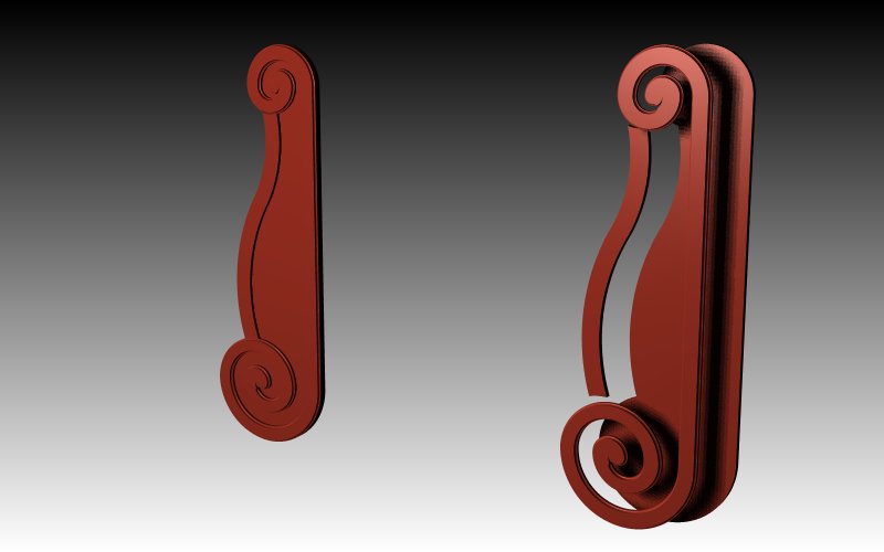

and the eCab drawing
We'll see how it cuts this weekend.

Nice work, but I'm curious, is that a typical Texas shutter?
PS. Hope this message finds you well.
Re: You can draw most anything in eCabinets
Dennis,
These are exact replicas of the shutters hanging on the Alamo. :lol:
Actually I don't know where they came from but they do look like they would be more at home in Santa Claus Indiana than here in Texas.
They were fun to do because I originally thought I was going to have to use a Cad Cam software to do the spirals but once again I found that all you need is eCabinets.

I originally did the spirals on these shutters in Intellicad using a lisp routine to create the spirals. The only problem was that the spirals were created as line segments instead of arcs so I just drew the spirals in eCabinets. Much better.
