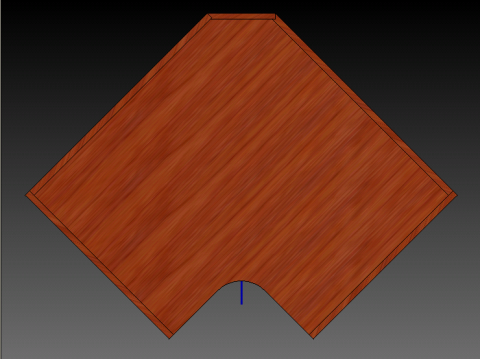

On the attached file, the fillet that I've added to the inside corner of the top disappears when the cabinet regenerates.
Is there a way to avoid this?

It looks like you have found a bug. I haven't found an easy fix other than to do that fillet last.

Thanks Kerry. This is a cabinet that I may be using fairly often, so I may need to get creative, and make it out of individual parts that I pull into the batch list when needed...

Nat, I reported that about 2 years ago while trying to build a library for one of my closet customers. Forrest

Forrest, this is for my closet library also. Were you able to find a work around? Thanks, Nat

You have to fix it every time you adjust the size. Forrest
