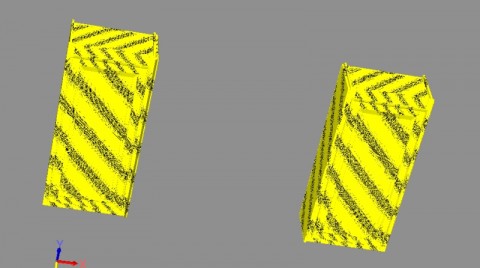

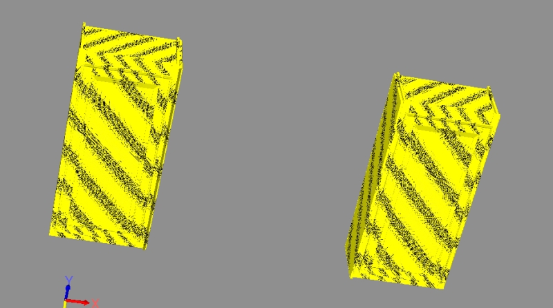

I think your cabinet files are corrupted. I can't place the cabinets in a room and when I open them in the cab editor I get this.

It seems to be something with my export selection. I cannot get any cabinet to load properly using that. Even the generic cabinet goes all yellow on me when I export and then attempt to reload. But I take it that the original problem in not all that common then.
