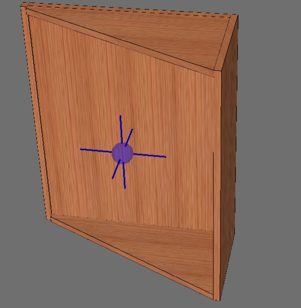

Hi,
I can't put a crown molding properly on an angled front cabinet. The molding doesn't follow the angle, it goes straight. I mean angled cabinet, when the left or right end has an inset, and the top and deck follows this inset (angle part).
So what is the solution?

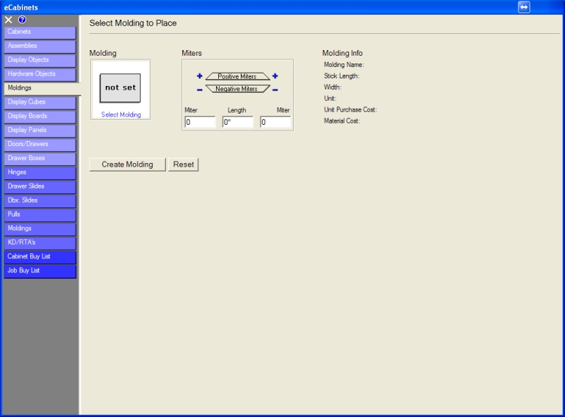

For a cabinet like this
You will need to go to the Moldings Tab in the Item Window and create the correct length molding with the proper cuts on each end and place it manually. Don't forget to associate the molding to the cabinet before you save the cabinet or the molding won't be saved
