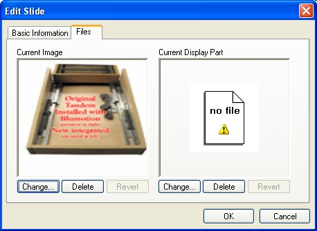

Trying to add images to the parts so you have a visible ID. I can load the image under the files tab but it won't stick. As soon as I select the part the image disappears and then doesn't show anymore.
How do you make it stick. I press the OK and then the Apply buttons. Still disappears.

I was able to make the Blum Lock picture stick on the slide mount specs. So I tried to make the pic stick on the Tandem slides, thinking maybe the pic was the problem, nope. I have a picture of the lock that works but I can't get the picture of the slides to work.
I tried my picture of the slides on the locks and it works. And I have a picture in my hinges that works. So it looks like just the slides picture won't stick. (for now)
Maybe a bug.

Re: Buy List
Leo,
You add the pictures in Preferences/Define hardware then when you choose a default slide the picture will show.
Leo Graywacz

Worked for all of them except the Slide. Tried several times.

Looks like when I add a part code it kills the picture. It really doesn't like the word Tandem

Re: Buy List
Leo,
Don't know what the problem might be. I used the word Tandem for a product code and it works fine.
Are you adding the image here?

Yep, that is the only place I can find to add it. If I put some nonsense in the part number like ABC I can keep the picture, but the true part number or other words and the pic disappears and even if I change the words I cannot add any other picture. I have to remove the part and add a new product and start over again.
Frustrating, no problems with other items, just the slides.

Re: Buy List
Leo,
If you change a product code eCabs thinks it is a new product and it won't access the image. Click Add product then enter all the information and the image then click Apply and your image will show up. If you change the product code your image will disappear.

I have tried all various versions of entering that pic. I didn't have any problem with any of the other items, all have a pic. Just this one is confounding me. I am pretty sure it ain't me.
