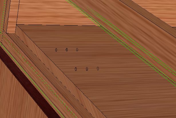

Thanks for your answer. I do know how to ad pull hole on my drawer front. But when I read the new feature for the build 8 it says: Pull hole patterns (drawer fronts and drawer box fronts) ADDED. So I thought that It would ad pull hole on the DRAWER FRONT and on the DRAWER BOX FRONT. I tried with a 1.5" negative thickness and it didn't work. Here is a picture of what I'm doing. So I guess it is impossible to also have the hole on the DRAWER BOX FRONT.
Thanks!
Dennis Englert
Re: Pull Hole
Post by Dennis Englert »
Audrey,
Check the Help menu for "Setting Hardware Defaults". There is a section about Applying/Clearing Defaults.
The image I've posted shows the hole pattern on the drawer front and the drawer box front. I think what is missing, since you've probably went through several iterations of trying to get it to work, is the Apply.
If you still don't get it to work, I'd remove the drawer and drawer box, then reinstall it. Then Add the Drawer Pull.
Dennis

YESSS!!!! I got it! I need to use the negative and the positive thickness!
