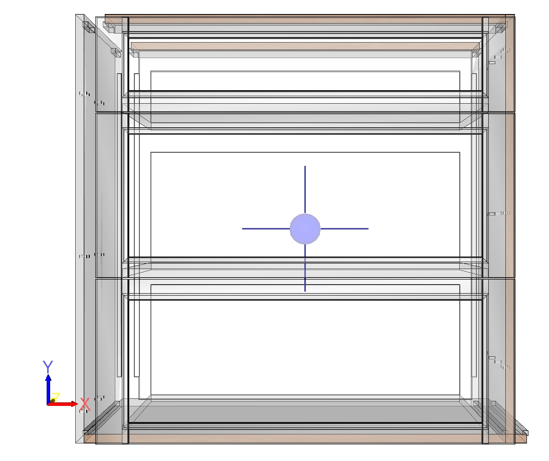

I cannot get the EB to change on any cabinet without screwing up the whole build of the cabinet. Has anyone come across this and what can I do to fix it??? TIA.

It happens with every cabinet that I try to change the EB. Here is the one that I posted the pic of.

I am not sure why, but your cabinet is missing some of its bodies and that is why your cabinet is messing up. If you right click and remove part editor cut fromt the entire cabinet. the cabinet will change edge banding correctly.

Why would I get this from all my cabinets?? I tried a repair and it didn't change anything.
