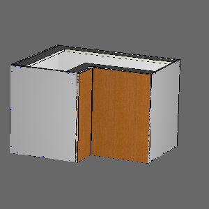

Hi i am have a problem with this corner cabinet attached. Using part editor i applied two bi folding hinge patterns
and when i nest the cabinet the holes for the bi folding hinge randomly move of the door.

Alex Bowler wrote:Hi i am have a problem with this corner cabinet attached. Using part editor i applied two bi folding hinge patterns
Alex,
I investigated this morning and it appears that if you regenerate the cabinet (go to construction settings and then select OK) all will then work correctly. The issue seems to be adding part editor cuts to slab doors on corner cabinets. I will get this listed and resolved, but for now (and this is only on corner cabinets), just do a regeneration one time after any PE cuts on doors and it will then work just fine. I checked this in V6B7 and it does the exact same thing, so it is not new to V6B8. Sorry for the inconvenience.
