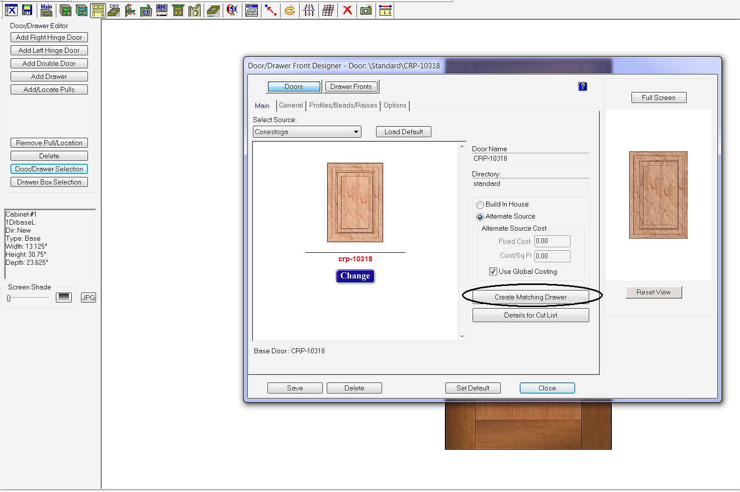

I need to make 5 piec drawer fronts. I've done this before quite a while ago and I'm remembering there was a box to check to make matching drawer front, when designing the door.
Am I getting forgetful in my old age or just blind?

Here you go -- Open up Door and drawer designer and away you go --

Have you upgraded to the lasted version? It's not there on the door side. If I go into the drawer side of it and pull up a conastoga drawer, then there is a button to create matching door. That doesn't make a lot of sense but it's there. It's just on a 5 piece, not available on MDF or slab. Slab I understand, why not MDF? I don't do those, but it makes sense to me to make a counter part.

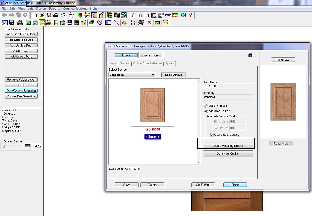

Yes I have Ray -- Check out the 2 boxes in the pic--
Re: door editor - make matching drawer
Ray,
Make sure your Display DPI is set to Normal .
I think any other setting causes problems with the way the buttons display in eCabinets.
Your Create Matching Drawer button may be missing in the dialog box because of this.
Ray Jorgensen
Posts: 199
Joined: Sat, Jul 29 2006, 9:11AM
Company Name: Classic Custom Wood
Location: NC Iowa
Post by Ray Jorgensen »
