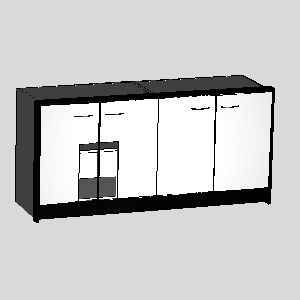

I am designing a kitchen for a client. I am new to eCabinet but went through the tutorials and managed to get most of it designed. I have shown the client the renderings and we made some changes. I do not know how to draw some of these so I wanted to see if someone might know how these can be done or if they can be done. It is a very stark and modern design with frameless cabinets and slab drawers and doors. The layout from left to right is a filler/scribe, a full height double oven cabinet, lower and upper cabinets in the middle, then a refrigerator cabinet, and then a narrow cabinet on the end with a full height 6" wide pullout pantry.
1) Originally they were slab with no toe kick. Now he wants to try it with a toe kick. How do I get the toe kick to overlap the sides instead of being between them. It is a different color and all I can do is get it to show between the cabinet sides so you see the different color of the side edgebanding. Not a huge deal but I would like the final rendering to look right. I know how to do a separate toe kick which would work between the oven and refrigerator cabinets but it doesn't work on the pullout cabinet to the right of the refrigerator because you see the end of the toe kick.
2) I understand how to make an assembly with two cabinets but I cannot get this to work. What I have is a refrigerator cabinet with a full depth full overlay double doors on top so they are 3/4" proud of the cabinet box. I want to put a 6" wide space next to it on the right with another end panel to house one of those full height narrow pullout pantries that Rev-A-Shelf sells. I have made the assembly of the two units but I can't figure out how to do the following details:
a) I want to cover the edge of the plywood on the left of the refrigerator with an 1-1/2" wide 3/4" thick (so it will be flush with the surface of the doors) that runs from just below the doors to the floor and flush to the outside and overhanging to the inside where the refrigerator goes similar to a face frame. I tried a face frame construction but it won't do a partial stile that I can see and I also want it flush with the doors and not behind them. I also tried a stretcher but you can't get it to the ground and you need to add a bottom to the refrigerator opening to even add it and then the software takes it away when you delete the bottom. So I cannot figure how to cover the edge of the plywood with this piece.
b) I want the pullout door of the narrow cabinet on the right to include this 1-1/2" "stile" for lack of a better word on the front of the refrigerator cabinet, and be notched around the door above the refrigerator and obviously straight down the right side which is the end of the cabinet run. How can I make this door to overlap the refrigerator box and be notched around the door above the refrigerator? The software makes you take the one-sided cabinet to the right by itself when adding a door rather than letting you add a door to the assembly.
3) He wants to frame the entire thing with a simple black trim. This will be 3/4" thick and will run up the left side where the wall is on top of the filler. Across the top like a crown but just straight across above the upper doors and then down the right side on top of the pullout door I was asking about in number 2 to the right of the refrigerator. I plan on scalloping in a cutout to use as the pull on the pantry door. I don't see how to add trim that runs vertically and on the surface of the cabinets. It will also have to run in, across, and back out on some not as deep upper cabinets in the center of the wall. This trim will probably be 3" wide and 3/4" thick.

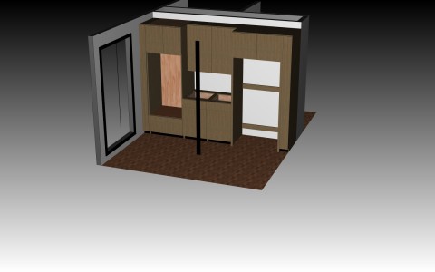

I was able to jury rig one of the problems but not all.
I was able to mostly achieve the look of the construction of the refrigerator cabinet and the adjoining pantry but the actual construction details are nothing like what will actually be built. I would like to get it to that point to help in the construction.
What I did was make a second set of doors in the refrigerator opening with 0" reveal on the outside and 36-1/4" gap between doors to end up with 1-1/2" "stiles" that run from the upper doors to the ground and are flush with the outside. But as I mentioned the construction details are wrong but it will look at least right in the rendering.
For the pantry I just eliminated the left side and narrowed it 3/4". Then I placed a zero reveal door on it. So the door is still separate from the partial height "stile" next to it but when the two pieces are placed together in the room it looks almost right.
I still have no idea how to do the frame trim around all the cabinets.

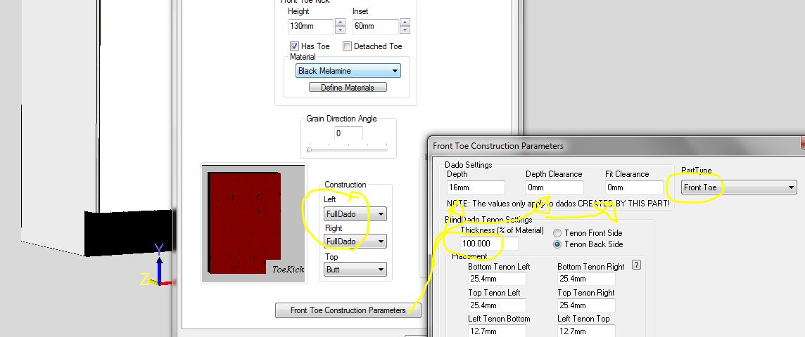

My kick settings
My kick settings

With the toe kick I use the full dado settings.

For your toe kicks, Take your cabinets to the Cabinet Editor, click the toe Kick Tab and place a negative 3/4" left and right inset on the kicks. This will give you the look you are after.

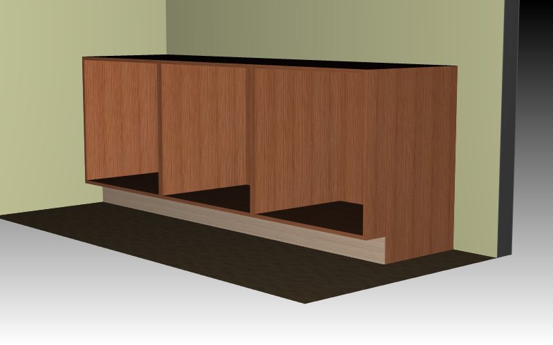

Scott, take a look at this example job, in the elevation view, if you hover over the Toe Kick you will notice it is a cabinet with all the parts removed except the Toe Kick. The cabinet is the same depth as the other cabs, the toe kick inset has been adjusted 1/4" for the thickness of the material, that way when inserted in the room it will place properly in front of the other cabs. Hilite it in plan view to resize as required, move it in elevation view using the Position on Wall dialog, or with the Move Increment. Try to utilize cabinet parts as much as you can for fillers, panels, etc as they are re sizable, therefore giving you the most flexibility.

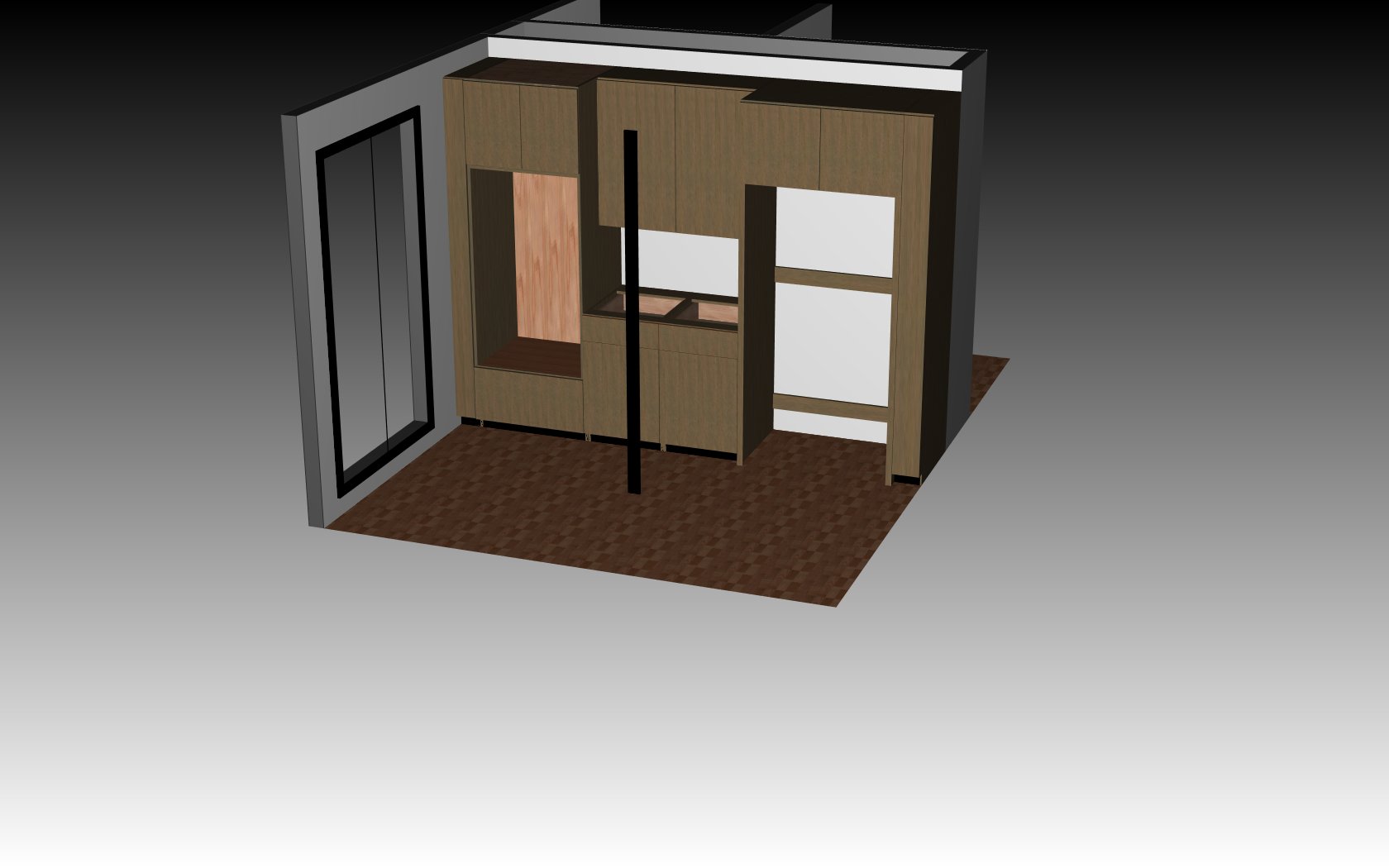

Here is what I have with the first piece of display cube molding added. But I can't figure out anyway to get it to move. This is the first one for the far left. Then it will run across the top going in and across the upper cabinets then back out and across the the refrigerator and down the pullout pantry on the right. It is not in the drawing yet but in the stub wall parallel to the right side of the pantry you can see behind it will be a microwave inset into the wall and then a wide pullout pantry below it.

Give Rick's method a try. The method of putting a display panel in Custom Layout is much more difficult and time consuming.
There are videos on placing Display Objects that will help you. You have to associate the panel to a wall, then you can move it in the elevation view.
