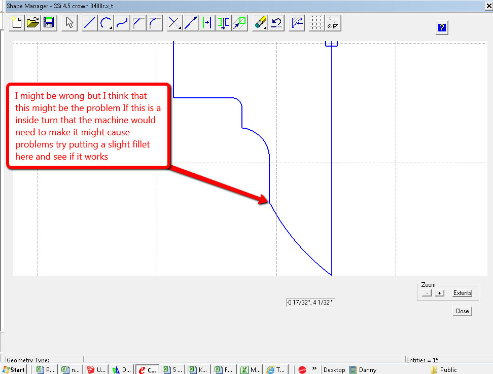

Hi forrest maby this will help
Forrest Chapman
- Posts: 1260
- Location: Anderson SC.
Re: Can someone try to model this please.
I guess I'm not sure what you mean by inside turn but I have many times machined square inside corners such as shown. I will have a chance a little later to redraw in cad the profile and try to figure out whats going on. One reason I wanted someone with a newer setup was to see how long it took to generate the toolpath. Forrest

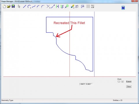

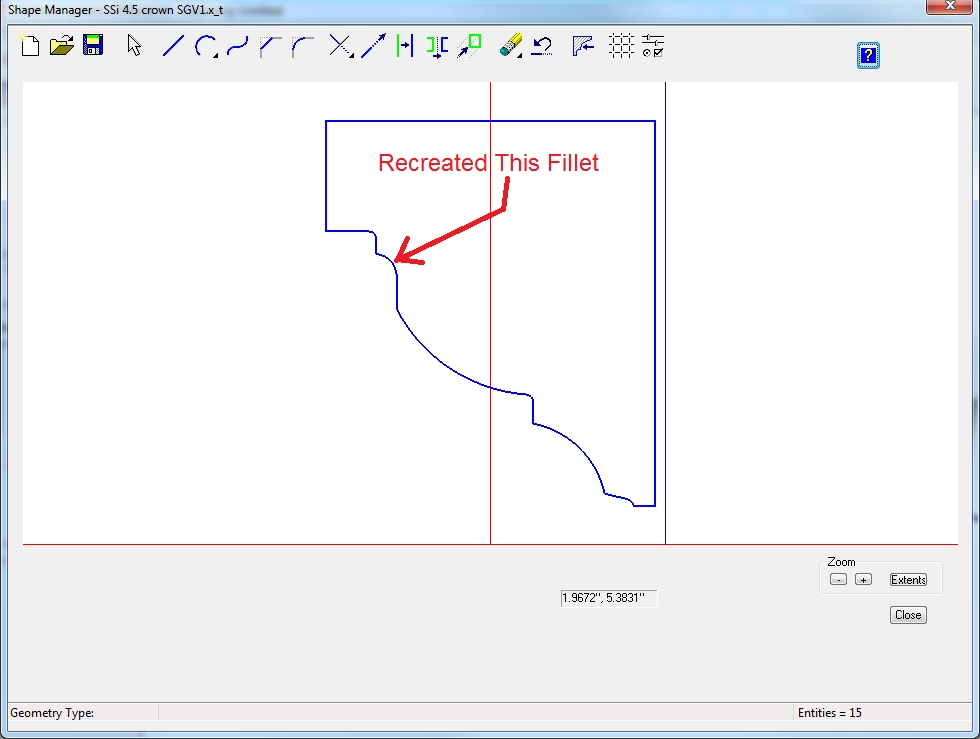

- Scott G Vaal
- Posts: 1740
Forrest,
Seems like it is the arc in the attached picture that is causing the grief.
I recreated it and now all seems to work. I have attached the modified .x_t file and the .tol file for you to review or use. Please try it on your exact part with the curve and let me know if it works with it.
Not sure what the real issue is with it, so I am going to submit this to the programmers and let them see if they can come up with anything.
