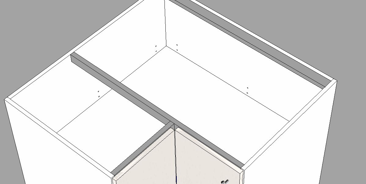

Hi Scott and Rick
How do you want to do your rails Rick?
Scott, I don't fully understand. Could you give us more details?
I like to do my rails like this attachment. I have used display panels here, which as far as I know is not adjustable or constrainable.
After assembly this makes the cabinet strong enough to pick up by the rails and maneuver.
Another feature i would like for corner units is to be able to put a row of adjustable holes down the middle back.

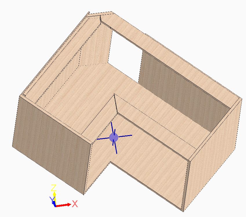

- Posts: 1896
- Location: Edmonton, Alberta
Re: Corner Cabinet Stretchers
Hey Guys, this is how I would like to do a corner cab. Love to have these attributes; Rails, separate center back, left and right insets on the backs, and be resizable too........Dreams are today's answers to tomorrow's questions.

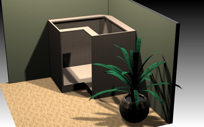

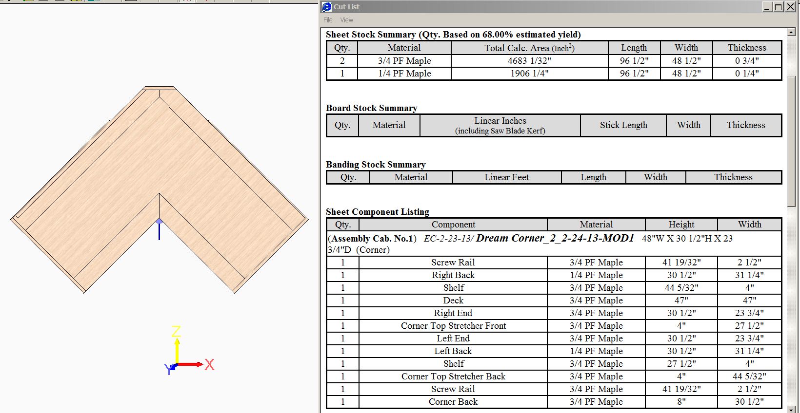

- George Davidson
- Posts: 1585
- Location: Norwood Pa.
Hi Rick
Here is something you can play with ????
It will resizes
It will resizes
