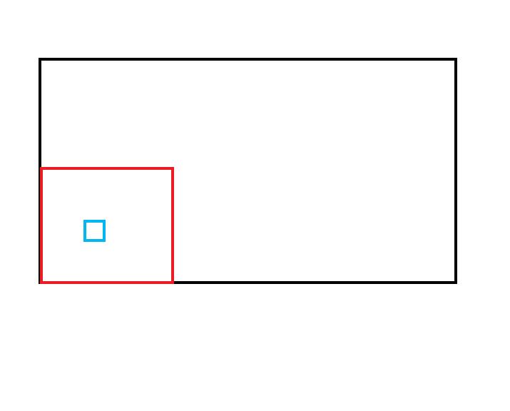

Sorry for the confusion. Should have drawn this first. As you can see a 36" x 36" panel with a 6"x6" cut out in the middle. I have Solidworks, I thought there might be a simpler way to "fool" the machine to tell it where to start.

If you use a fixture offset then it will move the sheet witch is to my understanding 36"x36" by the offset value .this will not move the 6x6 part just the sheet. The collar could be increased for example a 8 inch collar but this collar would be applied on x and y . so if you wanted the 6x6 part cut 8" on the x and 10" on the y this method would not worke.The drawing that you posted shows a large rectangle black lines (is this your sheet?) a smaller square "red lines" ( is this part going to be cut from the sheet?) and a smaller square "blue lines"( Is this a pocket/square hole or the actual part you are wanting to cut?)

From looking at ops drawing it seems not to be a nesting of a part but the part itself. If this is the case you simply draw the part and use dxf nesting and choose no outline.

Actually Scott the large black rectangle represents the table. The red is the 36" sq sheet.
Thanks for everyones input. Much appreciated. Will play with ideas on Monday.
