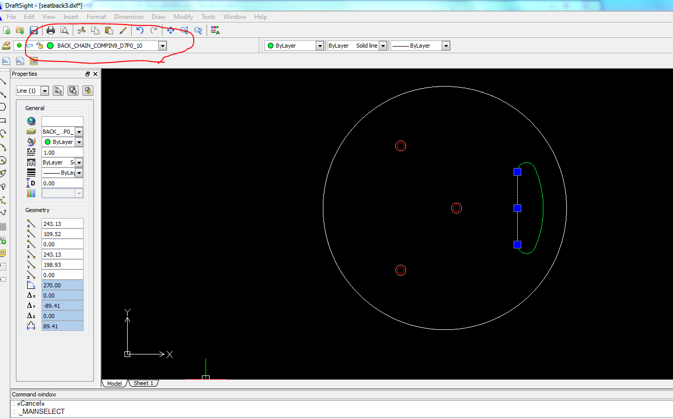

Daniel Odom
- Posts: 204
- Joined: Thu, Oct 20 2011, 12:52PM
- Company Name: Carlton Kitchen and Bath
Re: DXF files with flip ops
There is no z value in the layer name, see screenshot. Sometimes I have a problem where layer names that are too long get truncated and values are dropped off the end of the name. To counter this I remove spaces and any unnecessary zeros before decimal point "P".
I don't think that 's the case here though, looks more like a typo.
- Jeremy Schiffer
- Posts: 1154
- Location: Carnesville, GA
Hmm, good catch, Daniel. Indeed, when I open the DXF file in Solidworks (instead of the .SLDDRW file) I see it is truncating the layer names. I see it also is inserting the underscore between CHAIN and COMPIN/COMPOUT. I didn't have a space there. I did have a space between BACK and CHAINCOMPIN/CHAINCOMPOUT. I'll try eliminating all the spaces, but I bet that still won't get me enough room for the Z to fit.
Thanks for the catch, I appreciate it! I'll post back with my findings.

- Jeremy Schiffer
- Posts: 1154
Daniel, I owe you a beer, my friend! That was the problem.
