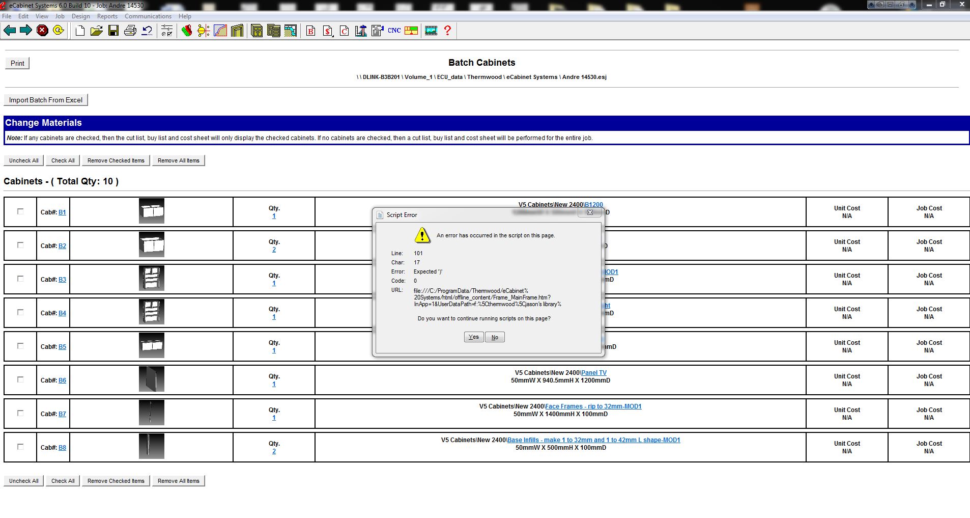

Hi there, so we finally got around to insalling a NAS and I've shared my library - copied the entire thermwood folder over to the NAS - and shared it and it SEEMS to work, but it keeps throwing up this error whenever i save or open jobs, does it pretty much all the time doesn't matter whether I click yes or no. Do you know what might be causing this?

I will quickly guess that it may be the apostrophe " ' " in the directly path. When it is being parsed by the "scripting sub-system" that "symbol" in "jason's library" may be messing things up. Try keeping apostrophe's, double quotes, @ and &'s out of the directory path names and see.
- Posts: 249
- Joined: Wed, Dec 10 2008, 3:29PM
- Company Name: Eastcoast Ultimate
- Country: AUSTRALIA
Re: Installing over a network
Great thinking. I'll give that a try. Thanks.
