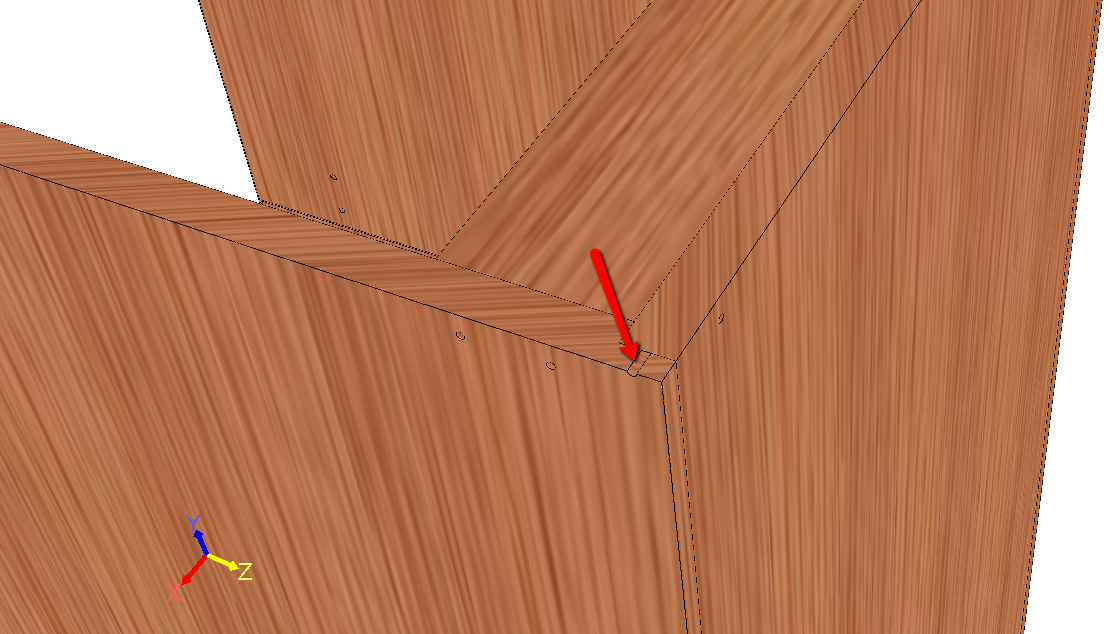

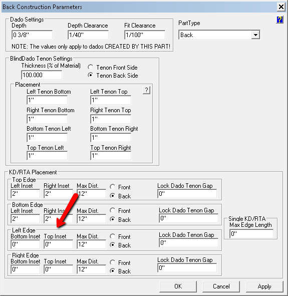

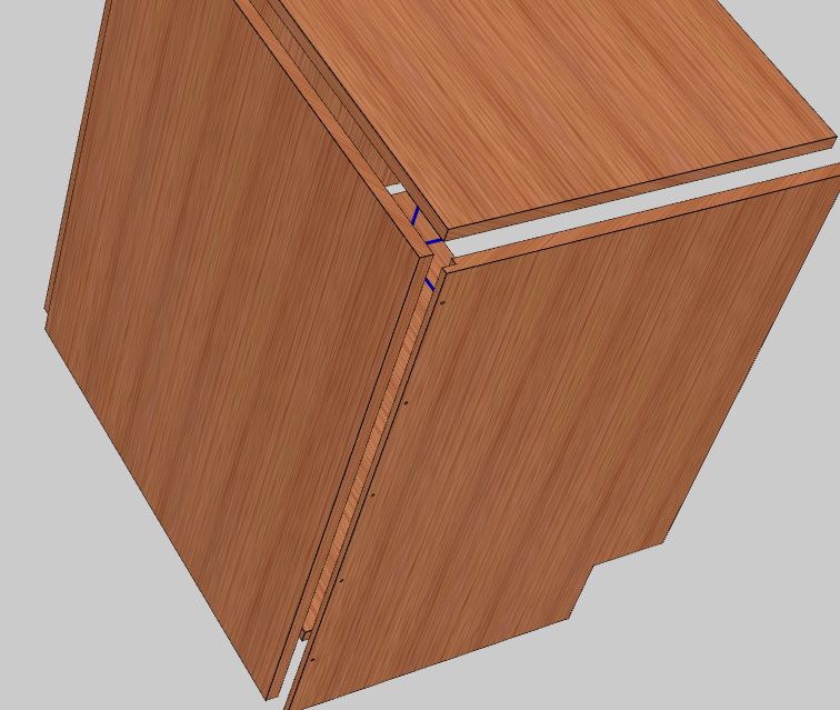

I would like to create pilot holes for the back of this cabinet I created a KD/RTA hole pattern that will make the holes That I need but for this part (The back) I would like it to be a full dado. So I Made the settings as shown. But the top and bottom pilot hole keeps being placed at the very top edge as well as the bottom. I can set the Left and right edge to 1 inch and the hole is in a acceptable location. But I would like if it is possible to keep the back as a full dado. Does any one have any suggestions on how this can be done using a lock dado and KD/RTA hoe pattern?

Doesn't seem to be a straight forward way to do it other than A) make a multi hole pattern and apply as a single or B) use RTA joinery>part editor/save edges>change joinery to full dado> part editor/ load pattern.

Thanks for your reply Daniel. I think that I will have to stick with the Blind dado as it will be easer for the user of this library to resize also there is a good chance that we will be using a 1/4 back instead.

When you create your hole pattern, offset the pattern 2" in the Y axis. This moves it away from the edge then use a 100% thickness tenon lock dado with 0" insets and 0" Lock Dado Tenon Gaps to apply the hole pattern. You can adjust how many holes using the Max. Dist. Setting.
This still isn't perfect but gets the job done.

Thanks Kerry but I already tried that it does move the top hole down where I would like it but unfortunately it moves the bottom hole down by that amount also. Is this the same result you get?

Yes, that is the trade off to get the holes placed automatically.
The best way to do what you want is to cut the holes in the part editor and constrain them.
