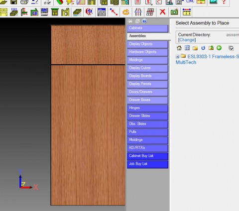

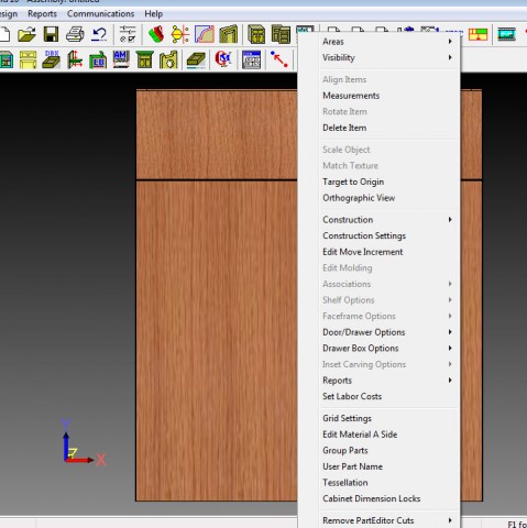

I'm on 6.0 Build 10 and I think I am clicking where you said but when I right click I see what is below. I don't see any 'Change Materials'. Also, the right sidebar does not show 'Adjust Cabinet Features'. Am I clicking in the right place?

I figured it out. I didn't know you had to be in 'Create a room/custom layout' to see what you mentioned as you did not specify.

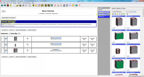

Alter a default base cabinet, wall cabinet and corner cabinet using the material joinery you want. Then you can either insert them into a custom layout and change the sizes when you drop them in or use the batch editor. I find it easier to just use the batch editor unless you have to make drawings/ renderings for approval; I find the custom layout process too time consuming for production runs.
In the batch editor I find it easier to change quantities and sizes on a whim. You make a core library and then just click on the cabinet and adjust sizes and quantity. Once you have a batch list you can easily swap out materials, doors and drawers using the adjust features bar or click on change materials. You can also click on a cabinet in the list and edit just that individual cabinet. I think you can do the same thing in custom layout, been a while since I've used it, but I find the interface in the batch editor to be much more simple and straightforward to use.
