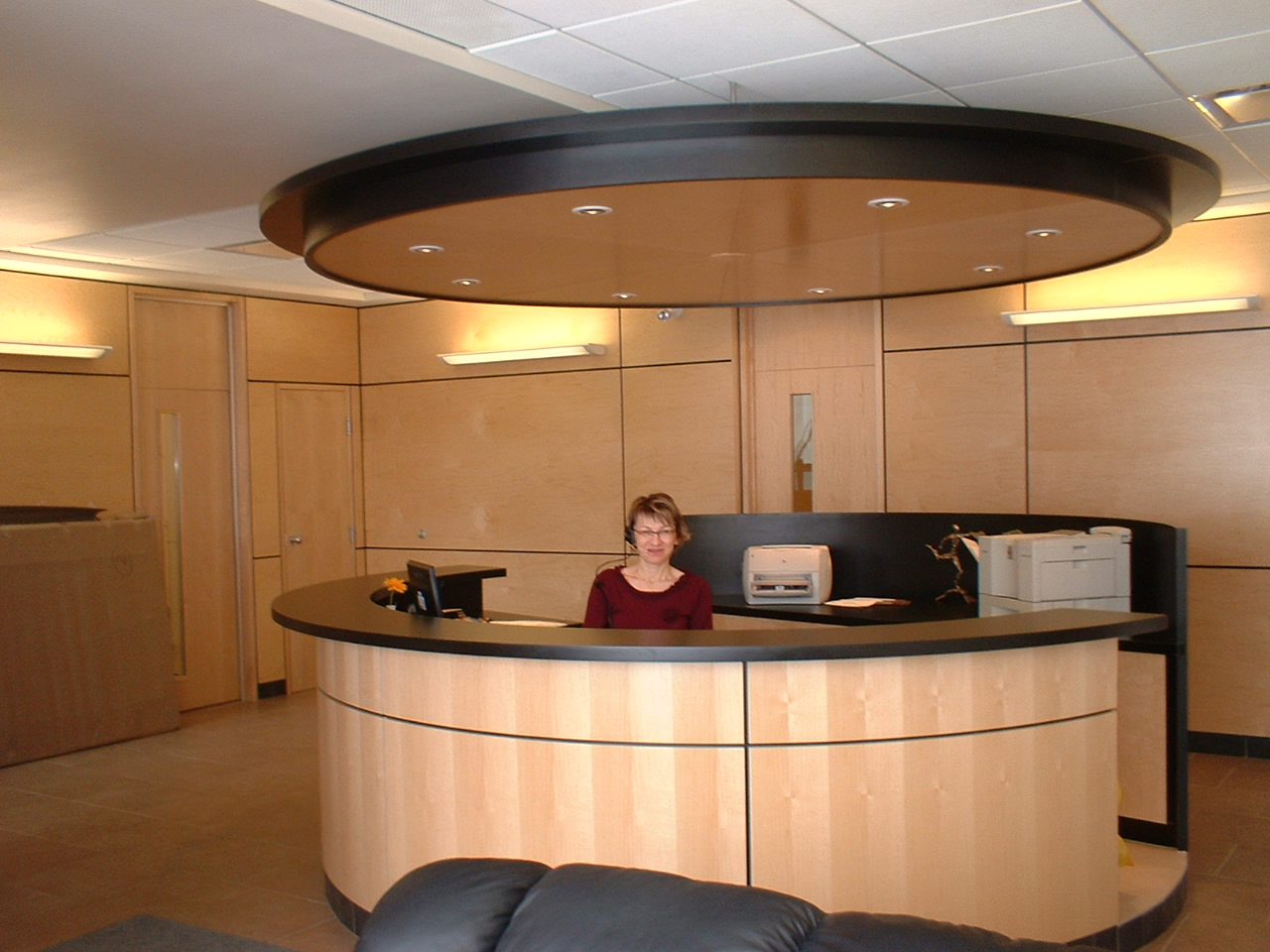

Reception desk and wall paneling.
Aspec31-03-2003 025.jpg (323.2 KiB) Viewed 8014 times

Wow! That secretary looks real.....Ecabinet does a great job indeed....LOL Just kidding of course. :D
Nice work

How do you make the curved front on the desk?

There's a couple ways to do this. This one was made by \"veining\" the back with a 1\\4\" downcut evey half inch or so. You than apply it to a frame with the form you want.
