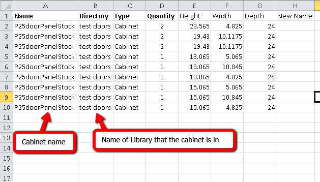

You need to have the name in the directory the same as the name of the library that the cabinet is stored in in eCabinets see pix
I replaced the Directory name that you have in the file that you posted with the name of the library That the cabinet /panel is stored In my program as well as the cabinet/Panel name and every thing worked fine.
One thing that I have found is that if you are using a spread sheet with formulas to calculate the panel and or cabinet sizes or if you have mutable worksheets with data in the workbook that the data is in you will need to copy and paste the data to a new workbook (Paste values only no formulas)Then save as a Excel 97-2003 Workbook. At least that is how I do it.
If the cabinet is located in a sub folder For example you might have a folder named doors and in that folder you might have one named mdf doors and another named 5 piece doors and the panel is in the 5 piece door folder the Directory name in excel would be "doors-5 piece doors" (without the" ").Hope this helps.

Another thing it doesn't like is a cabinet with everything deleted except the door. I just remade the cabinet putting the parts back on and it works like a charm. This will save a ton of time and human mistakes (the fat finger effect)!!
