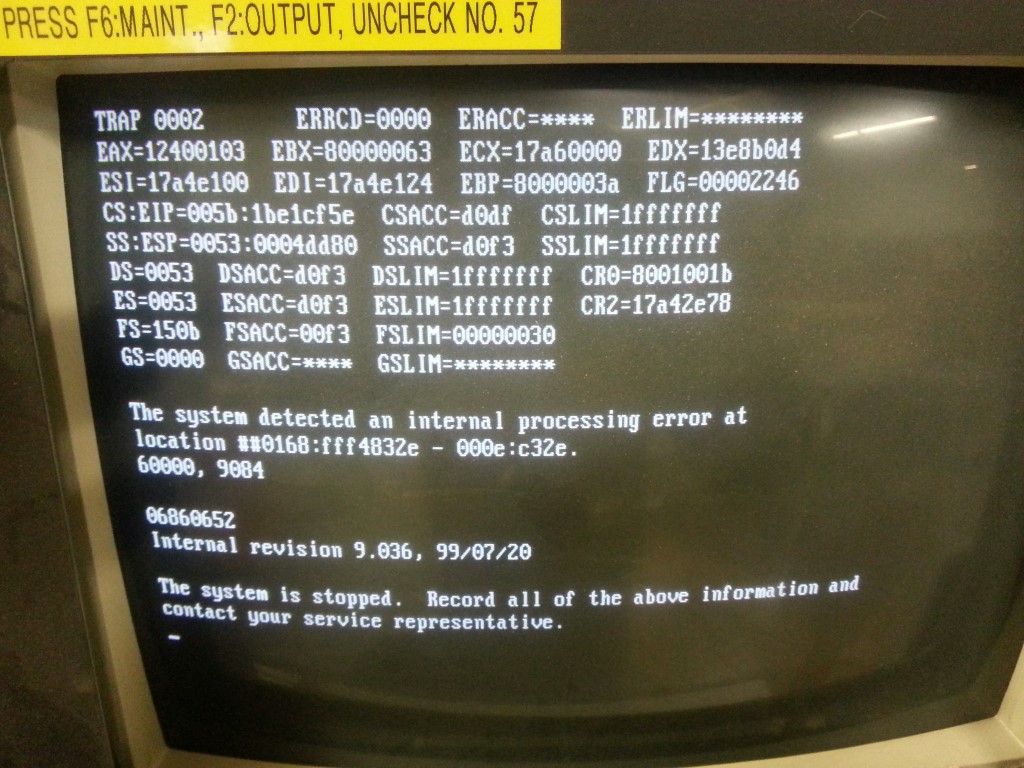

On occasion we get this screen at boot up. If we restart it starts up normally. Just in case I do have 2 backup cloned hard drives :D

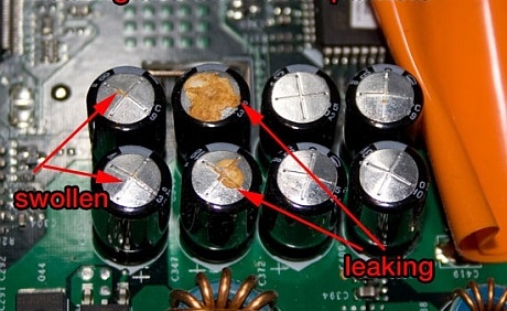

Eric, there are a few potential causes for an OS/2 TRAP 0002, but the leading causes are faulty memory chips and/or faulty capacitors on the motherboard. As electrolytic capacitors age, they can become less effective or defective and start to leak. Once this happens, it's all she wrote.
Open the control cabinet and peer at the computer's motherboard with a flashlight looking for swollen or leaking capacitors (see attached image), especially around the central processing unit and memory sockets. If you see any, then the motherboard needs replaced.
You can also try swapping out the memory cards with identical type and speed to see if the problem disappears.

We too have had errors pop up on start up ( and more ). Turned out to be a dicky power supply. I'm sure Dean's got this one covered with his diagnosis, but a faulty PSU can do some really weird things to your computer.
