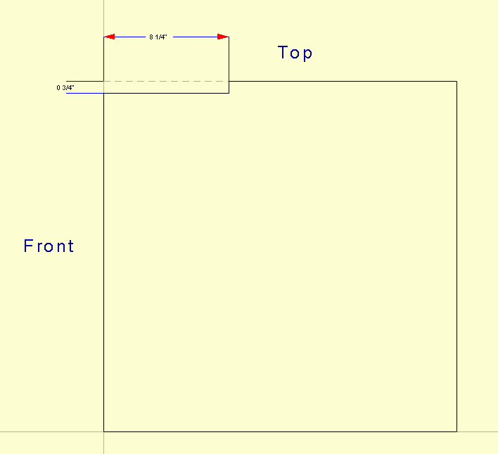

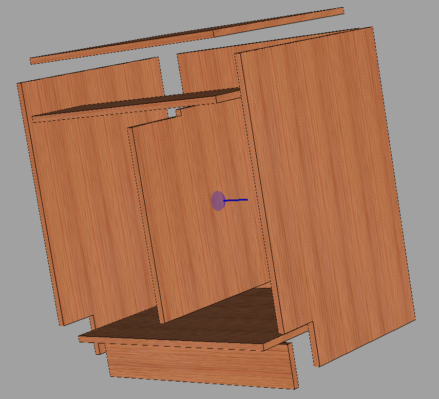

One more question. If I want to notch the partition for the stretcher, how do I do that? I can't seem to figure it out. i.e. I want the top of the partition to be flush with the top of the stretcher.
Ron
Scott Marshburn
Posts: 867
Location: Jacksonville Nc
Re: drawer stretcher
Post by Scott Marshburn »
Hi Ron. When you insert the partition set the top offset to the thickness of the fixed shelf make this a negative value i.e.. -3/4. Then return to main. Select the partition and take it to the part editor. Here you can make a pocket cut for the fixed shelf. I would then take the partition to the constraints manager and constrain the cut so it will keep the notch when the cabinet is resized.
