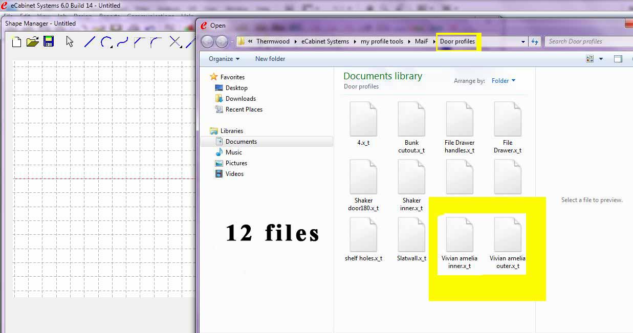

I seem to be having difficulty with the door and shape manager area.
I develop a profile in the shape manager and save it but when I goto load it into the door designer not all the profiles are there.
I can load some older profiles but not the new ones
If I open an old file into the shape manager and save it with a different name it doesn't show up either.
Any help appreciated.

The door drawer designer mdf tools area and the part editor profile edge function can only load tol files. The shape manager can load tol, x_t, and dxf files. You can create a tol file from a loaded x_t or dxf file in the shape manager using the create tool button. For more info on creating profile tools, click on the help in shape manager and look at the Creating Profile Tools topic.
