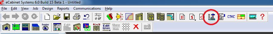

How can I create length dimension to my drawings? EX: distance between 2 objects, or a scale to use for reference measurements. I am familiar to AUTOCAD and AUTOCAD LTE, which has very easy click-to-measure abilities. but not seen the same here, as expected

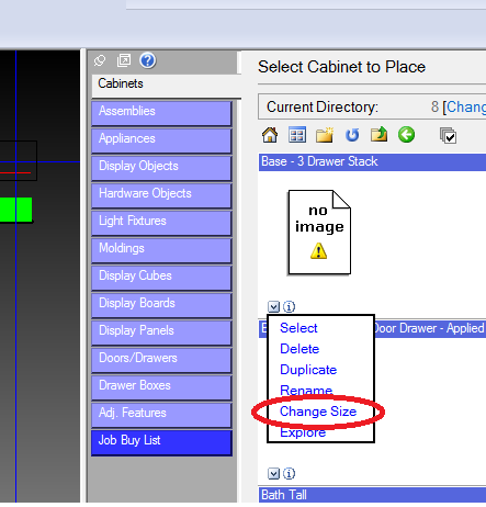

How can I set a setting to assign a length to each cabinet as it is set in the layout?

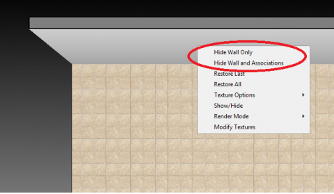

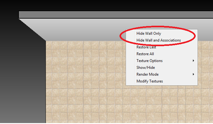

When I show a drawing or rendering to my customers, I can allow them a 3d rendering, but often times the opposing wall (like in a galley kitchen) obstructs the views. Any suggestions?

when rendering, right click on a wall and you will have an option to hide it

you can do all the dimensions you want in the Line Drawing Editor.
If you click on the drop down arrow on the cabinet in the item widow you want to change length, and choose change size.
You can hide wall in the render view, before you do the 3d rendering.
