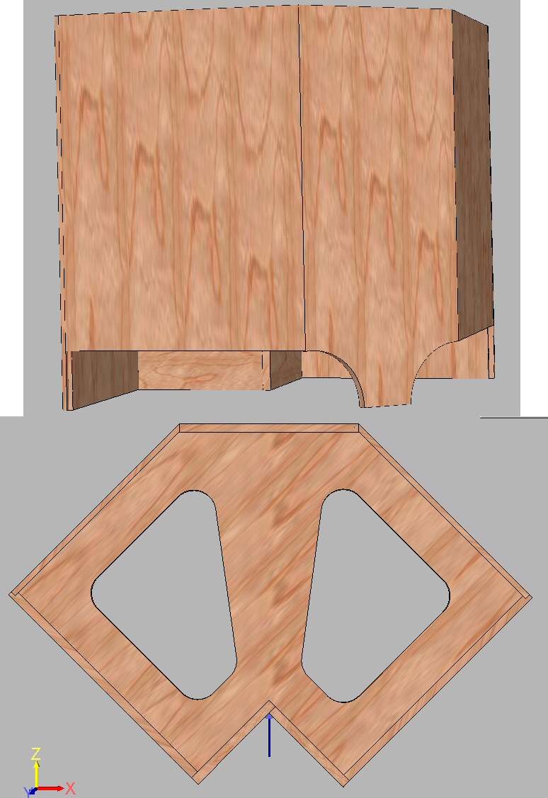

Open a job up that has a Lazy Sue Cabinet or bring one into the room editor. In the room editor highlight the lazy Sue cabinet.
Right click your mouse and choose Change Materials. A dialog panel comes up.
Uncheck the box on the parts tree so it shows an "X". Open the parts tree up by pressing the "+" sign
Put a check mark in the CENTER BACK. The material it is made from shows up in the lower column. Highlight the material by clicking on it and then a picture of the material will show up in the left window above it.
Choose SELECT NEW MATERIALl from the right window next to it. Your Materials listing should show up. Click on the material you wish to exchange it for. Click on OK.
Click Apply and in a few seconds it should show the new material in the tree above.
There are some things that need to be done in the cabinet editor now. So press OK and that brings you back to the room editor. Press the edit button to get the lazy Sue into the cabinet editor.
Click on the Construction Settings icon and then click on corner settings, then check the box MITER CENTER BACK.
Go back to the by pressing OK. Then flip the cabinet so you have access to the backs. Click on either the right or left back to highlight it and then bring it into the parts editor. Use a rectangular geometric shape to remove the bottom of the right/left back so the back will no longer touch the floor. I bring mine up to the bottom of the deck. Do the same for the other back.
Couple of notes.
I find that you need to use either no top or a full top. If you use the stretchers it will make the bottom funky and it won't reach for whatever reason. Some glitch that happens because the 3/4 and the 1/2" backs want to miter on the outside of the plywood. Personally I use a full top that I cut a bunch out of. Makes for handles so you can move it around and leaves a center area to attach the turntable hardware to.

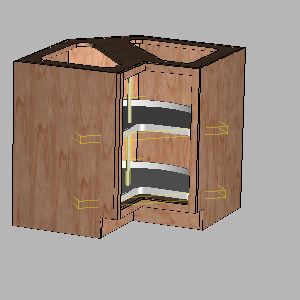

Here is my 36 x 36 Face Frame Lazy Susan
FF Lazy Sue 36 x 36 w Turntable.jpg (13.47 KiB) Viewed 14930 times
FF Lazy Sue 36 x 36 w Turntable.hsf
(812.02 KiB) Downloaded 1155 times
