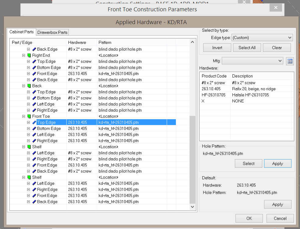

I'm hoping there's a forehead-smacking "doh!" answer to this, but I can't seem to find a way to clear the hole pattern and/or the hardware from any of the parts in the KD/RTA window. For instance, in this image, I want to remove the hardware and hole pattern from the top edge of the toekick so it doesn't get added & drilled. It seems like once the hardware and pattern have been specified, there is no way to un-specify them. What am I missing?

Take the unit into cabinet editor, construction settings, toe kick, then change construction settings - left -right- top. There are other ways i am sure, but this should get the job done.

I think the only way to remove the KD hole pattern is to edit one of the hole patterns in the hole pattern editor by removing the holes and naming it "no KD hole pattern" . Once that is done then you should be able to use global item editing by going into "applied hardware", selecting KD hole pattern, and replace the old pattern with the new non-hole pattern that you create. The only other way is to take each cabinet into the cabinet editor and change the joinery method. If there is an easier way I am not aware so hopefully someone else may have a different way. Hope this helps.

Select the cabinets in Custom Layout or in batch then go to the Global Item Modification and choose the Applied Hardware tab.
Using the drop down menu choose Kd RTA fitting or KD Rta Hole Pattern then you can choose the specific hole pattern or All and select to remove them or replace them.
You can also do this to a full library from the Global Item Modification Item Options Tab

Kerry, I have tried to do that but the removal button is greyed out and I can't activate it. I am not sure if I am missing a step.

Are you wanting to keep kd construction on the top of the toe kick and just not have the pattern and hardware added or are you trying to do a lock dado with no hardware or pattern?

Ralph
I guess I should have tried it before I spoke. I guess I have never removed the KD hole patterns I replace them with a hole pattern with no depth I created called No RTA,
this lets me keep the lock dado without having a KD.

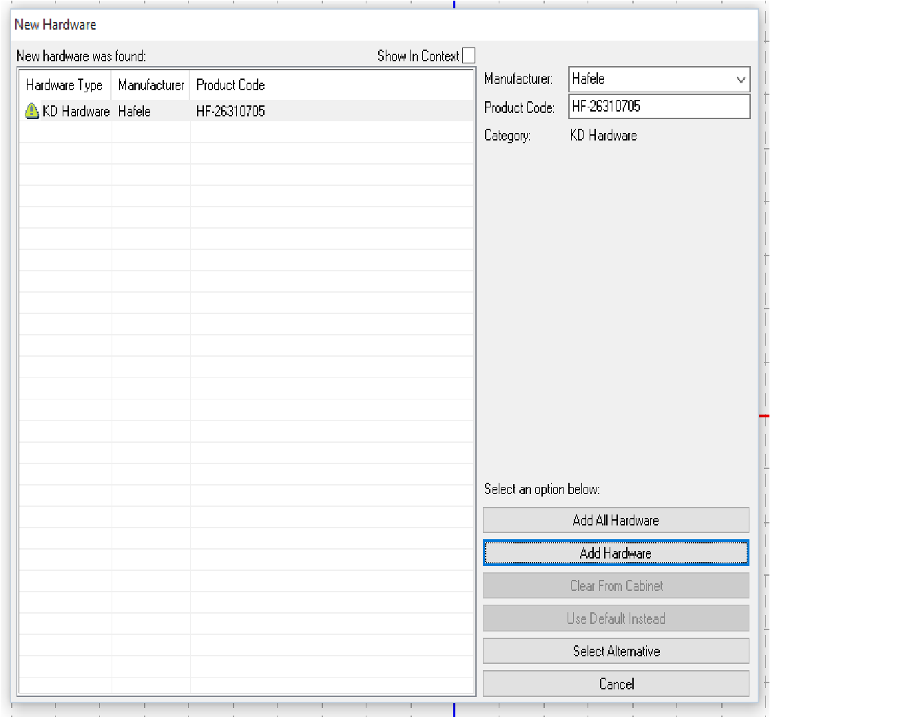

Before opening the cabinet delete that item number from your hardware in Define Hardware. I found it in Shelf Hardware.
Now when you open the cabinet a dialog will pop up asking if you want to add the hardware.
Select that hardware Item number and choose to remove the hardware from the cabinet.
The buy list won't show the hardware now.
I think that is shelf hardware not KD's

Thanks Kerry,
I removed the item from Define Hardware as you said. Then pulled from the cabinets into the editor and yes a dialog pops up. However, the CLEAR FROM CABINET is greyed out.
