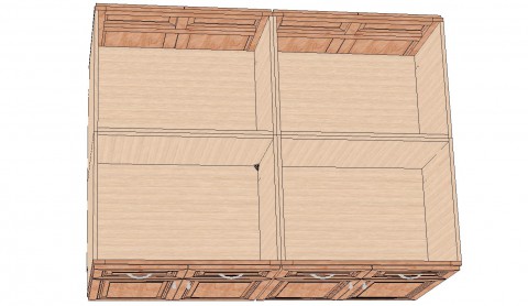

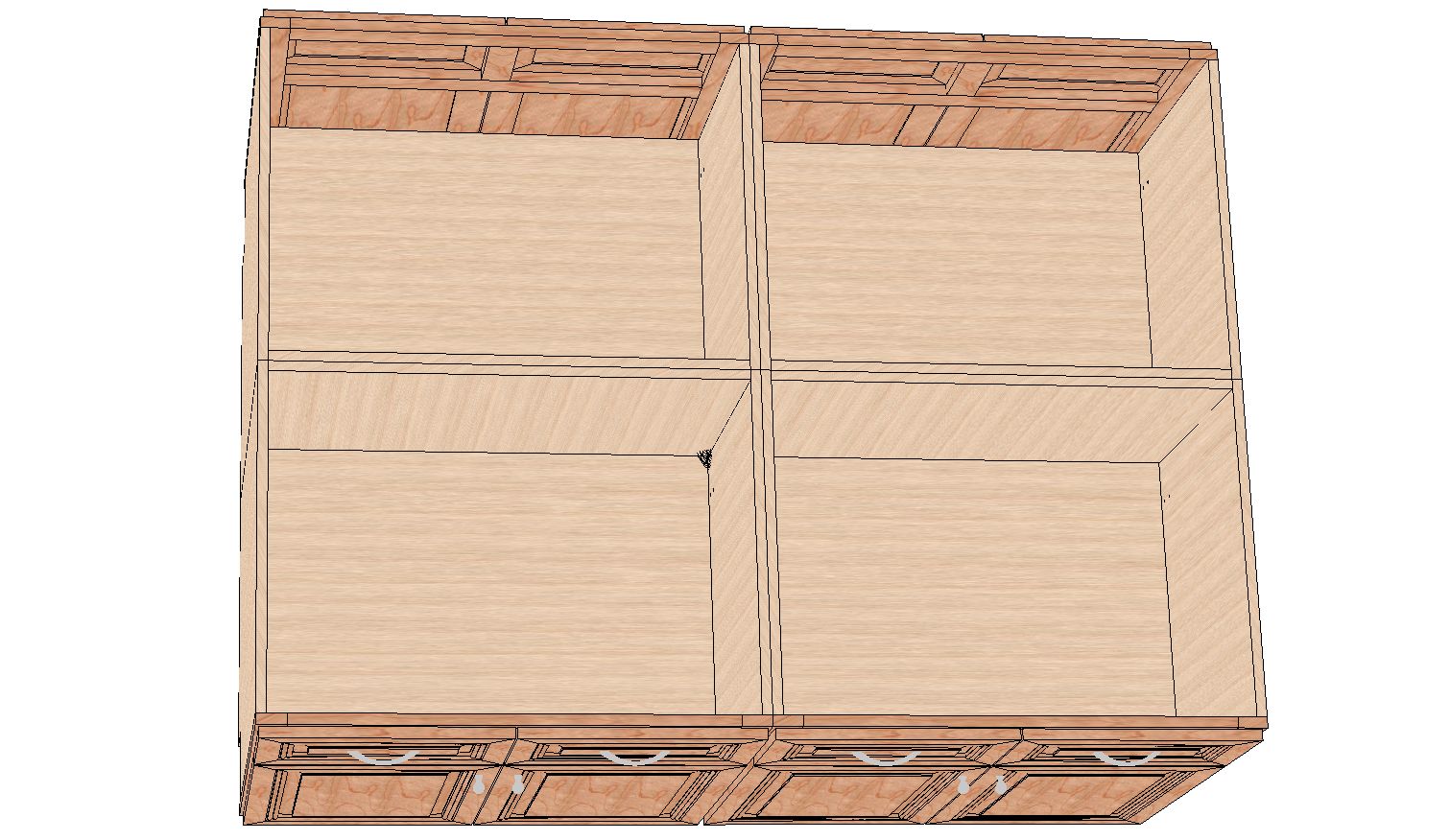

For islands I find it better to create an assembly in cabinet editor, bring in one cabinet got to top view move cabinet off target bring in another cabinet, rotate one cabinet 180 then select both cabinets, use item alignment to align the backs to zero - save as an assembly then when you place your assembly in the room you can rotate all cabinets in the assembly at once.
Hope this helps
