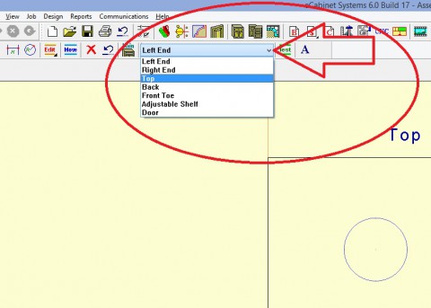

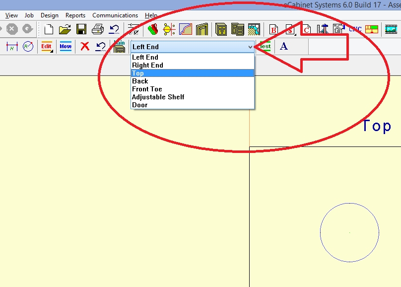

We will have it deselect when returning out of the CM.
However, just want to make sure you know that you do not have to leave the constraint manager each time to select a different part. You can select between any part that has a part editor cut applied via the drop down at the top of the constraint manager and apply all needed constraints to all the parts at once. Then, it will only have to regen the cabinet one time for all the applied constraints. hope this helps.
