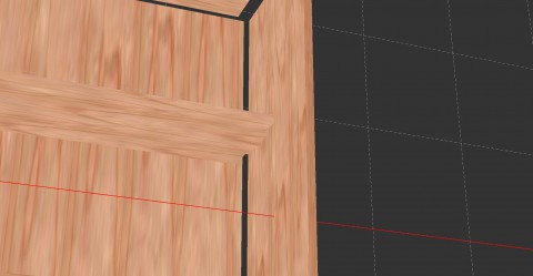

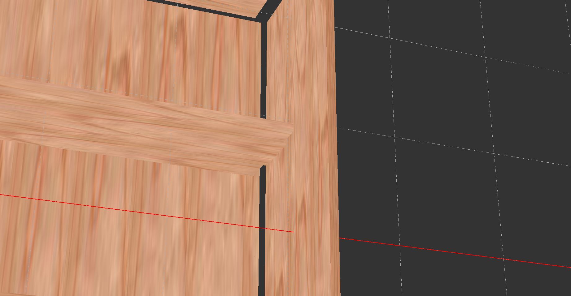

Today I'm throwing together another job and noticed a cab's right end not getting a dado for what is clearly shown to be a blind dado on a fixed shelf. Again, on the right side of a cabinet only. Left is show to be correct.
My hunch is somethings is either jacked up with my current ecab software version running on my computer or there's something up with the latest version? Anyone else seeing this problem with 'freshly' created cabs right side's not getting milled correct?
Right side oddities...
Re: Right side oddities...

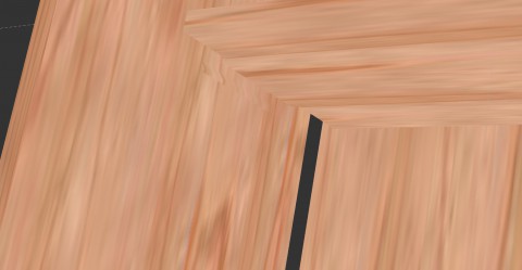

It's nesting with the dado's on the left and right side so this appears to be displaying improperly. Making the right end transparent reveals the dado geometry is there. Odd....
