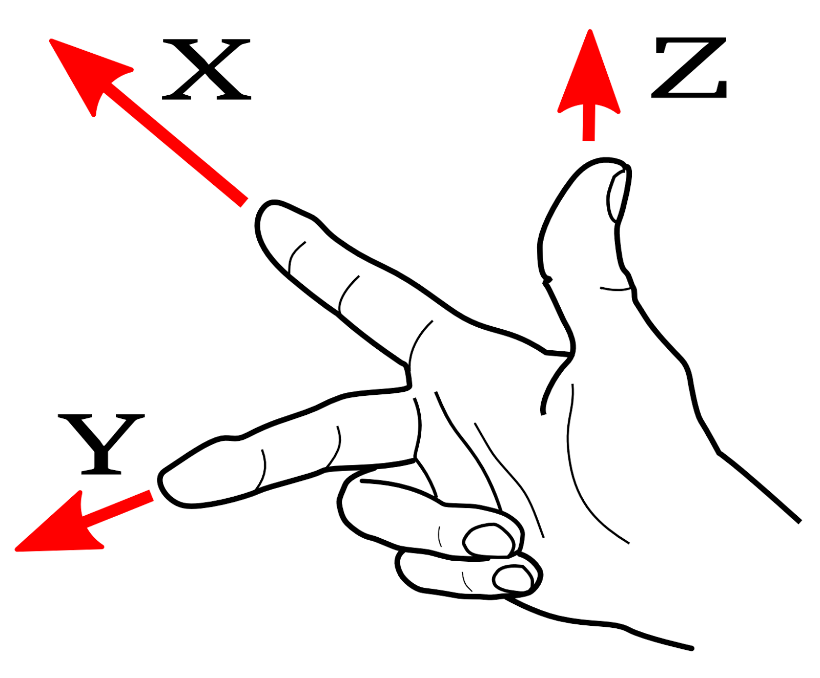

Be careful to review the other axis as well... Thermwood's machines have used "right-hand rule" for decades. You will want to check and see if you software "rotates" the X and Y axis in order to stay relative to the +Z downward direction. (This would be "Inverted right-hand rule".)
The image below illustrates "right-hand rule". The fingers/thumb point in the POSITIVE directions. (Inverting the hand would result in the "inverted right-hand rule.)
If the X & Y axis are correct and it is just the Z that your post "reverses", as Will suggested - just check and see if you can "negate" the Z output in the post.
