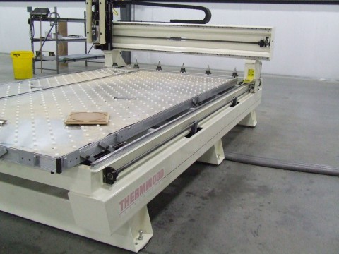

It was that post that got me thinking about these stops. I have included a pic of the machine that shows the fixed stops. They were mounted with shims behind them against the table to align them to the cutting path of the router. I have been using a fixed fence like the one you have but just holding it against the pop up pins. I have been using a G52I location for this fence. I thought I could devise a method of holding the fence to the fixed stops and that would give me a repeatable location without needing to use the dowels.
I looked through the manuals I have and could not find any information for locating the fixed stops. I have a pretty good idea of how to get there but like to gather all the information I can as I have found it saves heaps of time :roll:
I do know where the m999 macro is and if I can manage a good repeatable setup I will alter the G902 to reflect this.

Are you talking about those fixed blocks on the side of your table? Thermwood has the original setting for this machine as it was delivered. Call programming tech support ask for Daniel

Yes those are the stops I am referring to. I have been considering mounting a piece of wood to the stops to raise them as I use 1/2" MDF for my waste board and they are a little short when the sheet is new. This would allow me to mill them to a given dimension off the g901 location and also I would not need to shim them to align them with the cutting path. I will give Thermwood a call.

Just wanted to update this. I mounted the stops off the cut path of the router by routing a 4 X 8 sheet off the g901 position left the vacuum running then mounted the stops, measured to the cut sheet and then shimmed to make all the stops an equal distance. I then cut my square off these stops and as Will suggested drilled the intersection of the cut to give a clearance and recorded this center point as my fixture location.
