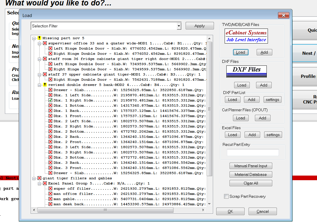

there is an issue with control nest 5.88 running on thm 9.09
to reproduce my issue you load a twd file and nest it and the go back to the load job menu and it multiples all the values by 25.4 which is 1 inch converted to metric

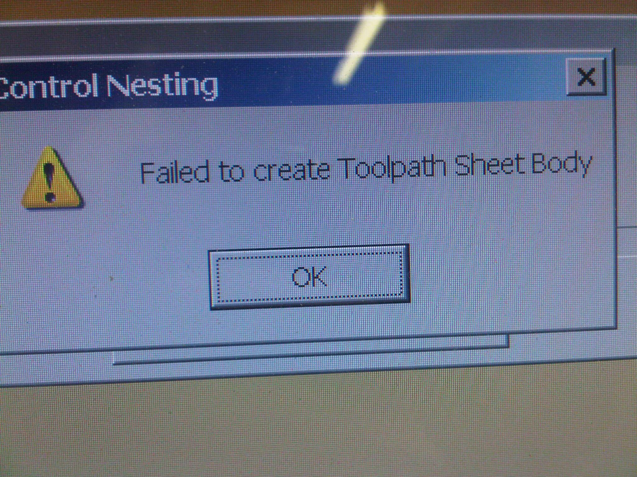

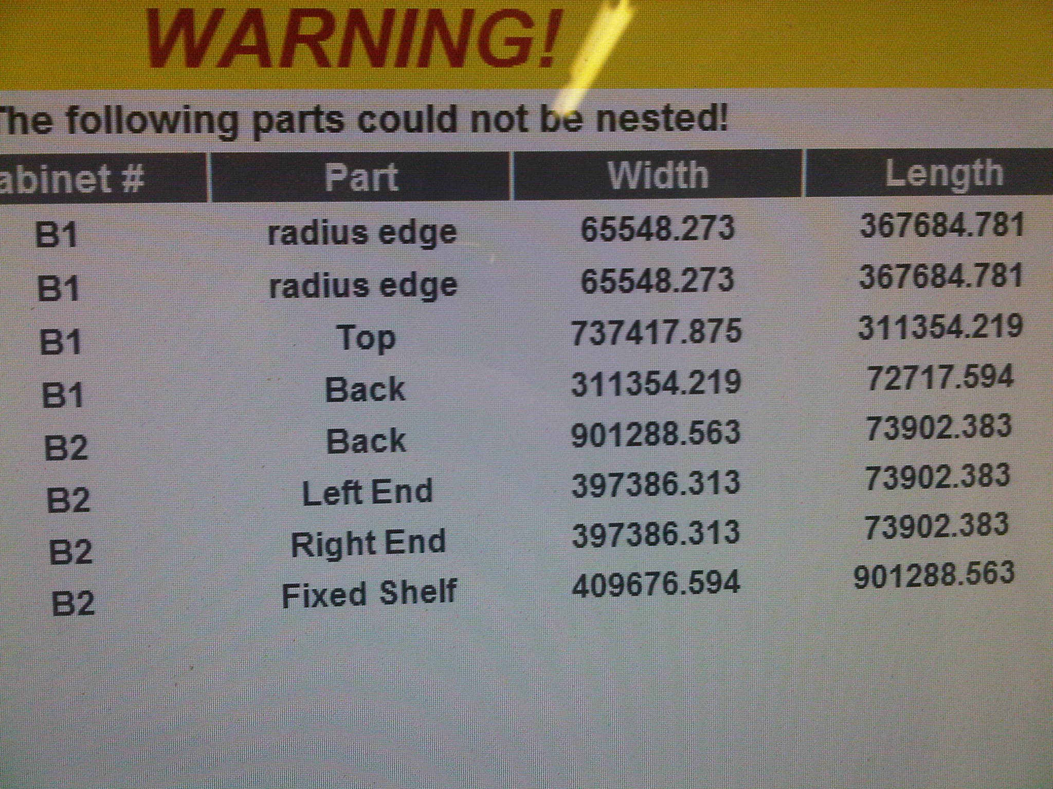

I'm having a similar issue. A "Failed to create Toolpath Sheet Body" error, and then an error saying parts can't be nested, and the listed sizes are comically huge. I had to restore to the previous version to get back to work, but when I get a chance I'll try to do some more troubleshooting.
