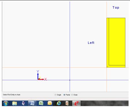

HI, I have a display board (16"x3"x3/4") in the part editor and can't put a single profile on the bottom edge. It cuts off the bottom edge instead.
I can put the profile all the way around or singly on the other three edges, (left, top, right), but not the bottom.
Is it me, the software or hardware? Does anyone know how to get it done?

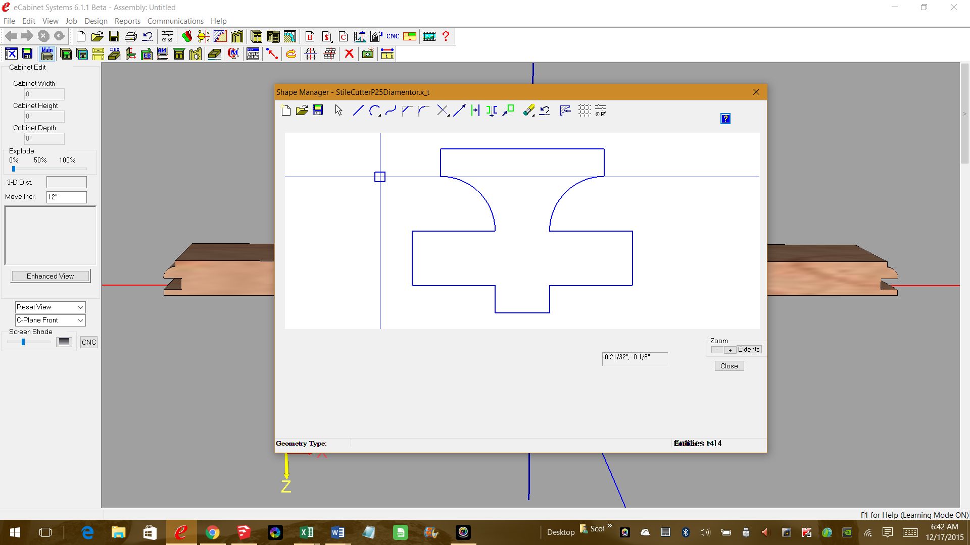

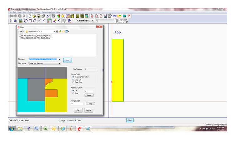

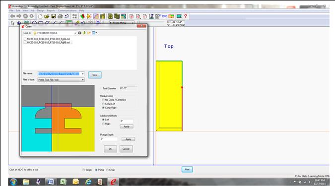

If you draw the cutter as per the pic below and set the diameter to be the distance between the beads for example the cutter that I made the diameter was ¼. You can use the radius comp feature.
On the bottom click on the right bottom corner. The red dot should be on the left.
In the radius comp section choose comp Right. In the additional offsets section select comp right. Make sure that the distance is set to 0.
On the top click on the top Left top corner. The red dot should be on the Right.
In the radius comp section choose comp Left. In the additional offsets section select comp left. Make sure that the distance is set to 0.
I hope this helps.

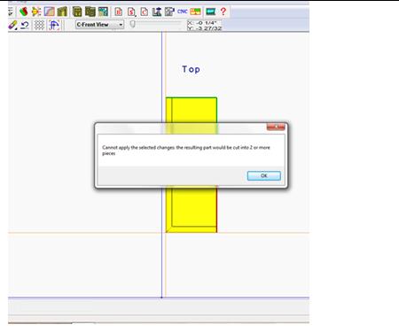

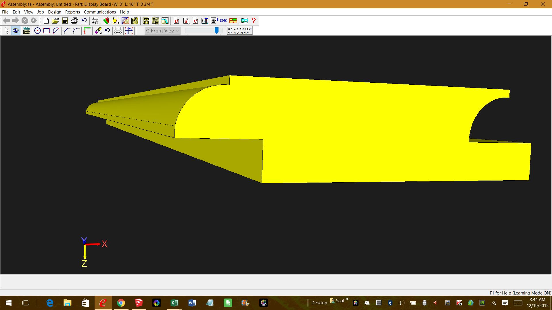

Changed cutter design as Scott suggest and I could put a profile on bottom edge. Thanks Scott. But....................................

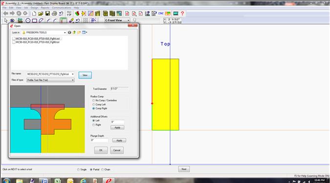

I ran into a problem with putting two different profiles on the same part. Pics below:
Using 'A' bit on two edges
Good result.
Good result.
A BIT 2.jpg (13.83 KiB) Viewed 13577 times

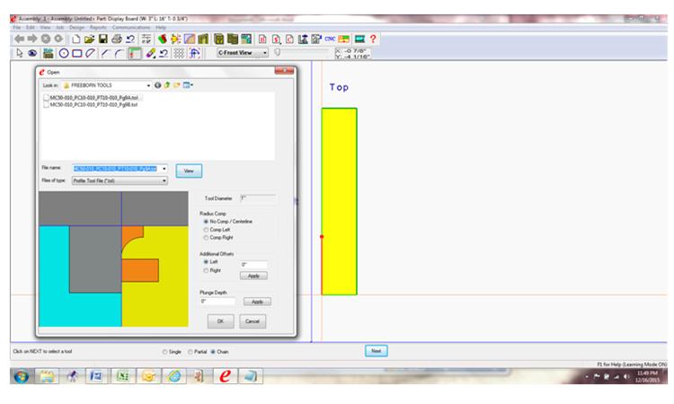

Set up for second profile on same park,

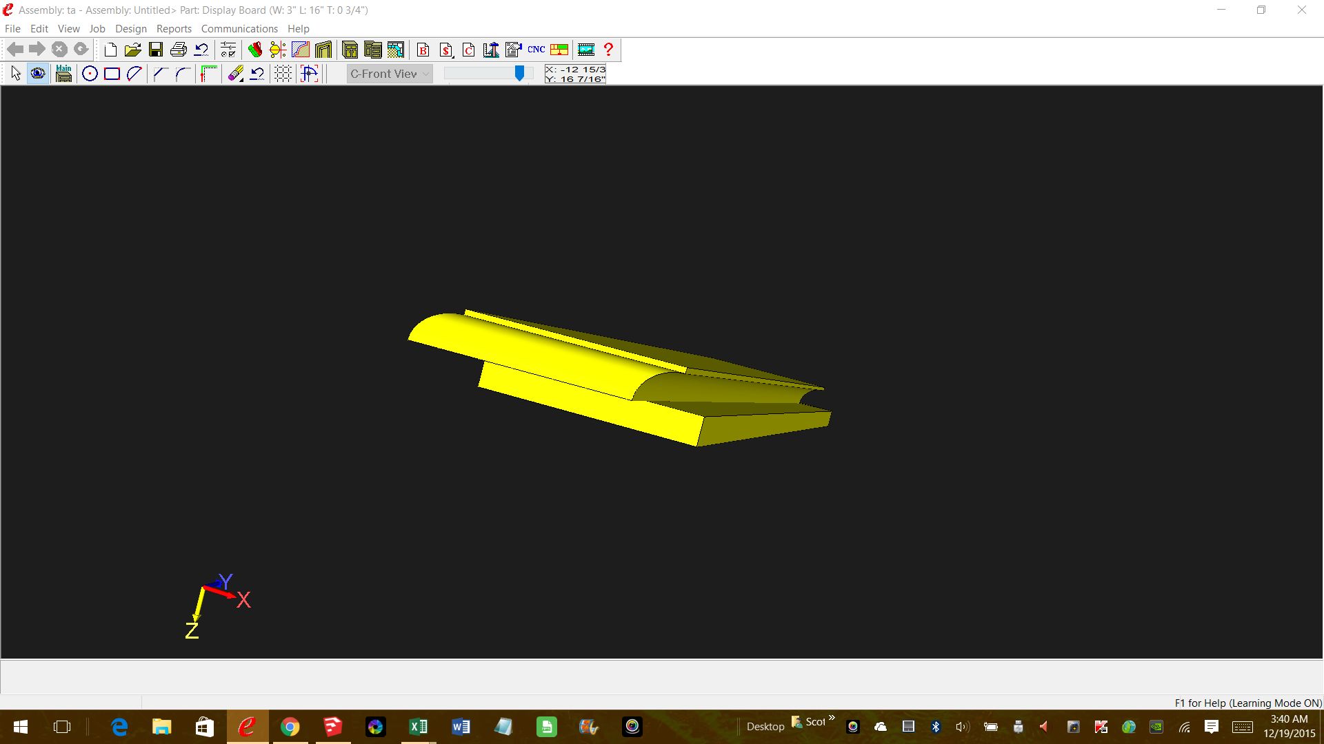

The result .
The result .
B BIT 2.jpg (14.49 KiB) Viewed 13577 times
I switch 'B' bit for 'A' bit and could put a profile on the last two edges.
Does this mean you can only put one profile per park???
How would some one put more then one profile on the same part?

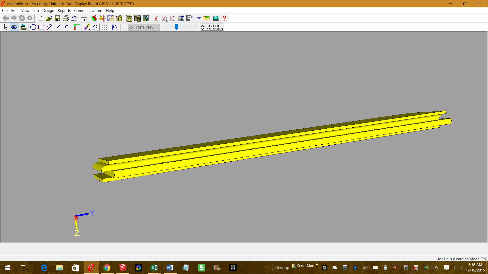

I downloaded the cutters that you posted. I got the same results that you were getting. I noticed that cutter A had a slight flat on the bead (See the original cutter screen shot below).As if you may have used the fillet tool to create it. This is common with using fillets. So I redrew both cutters and used the three point arc tool to make the bead. Tried her again and it works like a charm.
Here are the new cutters that I made. Let me know if they work for you.

Thanks Scott, your cutter worked. I make my cutter radius from a circle so I went back to my cutters and used the three point arc and my cutter also worked.
