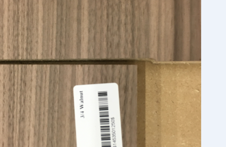

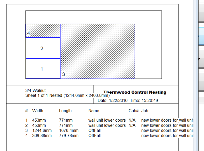

this isn't a huge issue more of a curiosity
when I nest a job then check off make off fall square and cut it the off fall isn't perfect square if there is another off fall touching it
square off fall

ours cuts the same way and I always wondered as well. The difference is about 1/16" or less, so i never worried about it.
