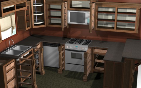

I'm just curious how you guys distinguish door swing on your line drawings and also no hinge pull out doors. Any suggestions on how to address cabinets with accessory items like trash pullouts.
Re: Door swing
Carmen,
I place pulls on the doors to designate swing. For things like trash and spice pullouts I place the pull at the top center ( or bottom center for uppers) to signify no hinge. I also place display objects to show the trash or spice pullout.
Be sure to tell the client that the pulls are for display only.
