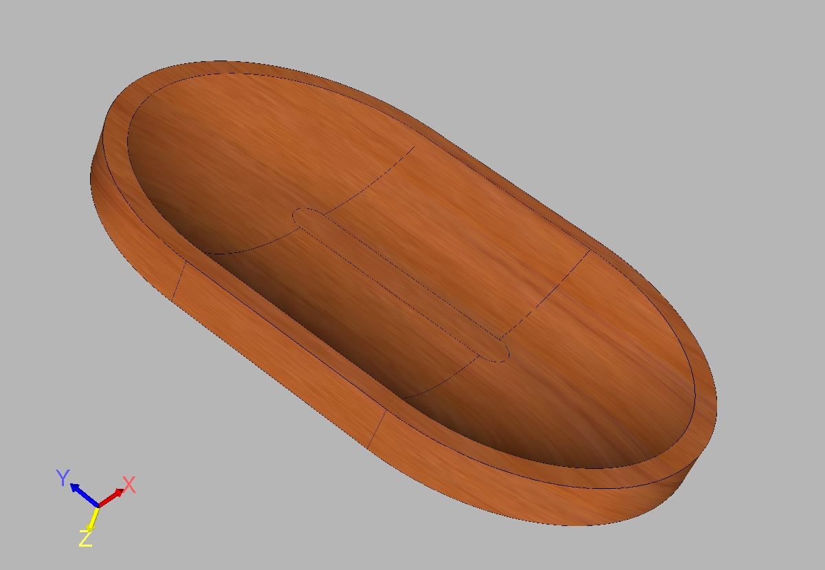

hey looking to find an easy way to make a simple dished out program for a thick piece of solid wood...so would need it to ramp in and out of the board...probably spherical maybe oblong lol...What do people out there do ?
Re: Dished out profile

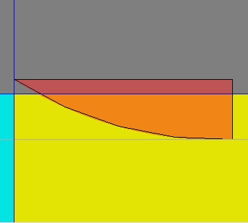

Marco,
You can create a tool in eCabinets and profile your part then cut it using Profile Modeler.
Scoop Tool.jpg (12 KiB) Viewed 5781 times
