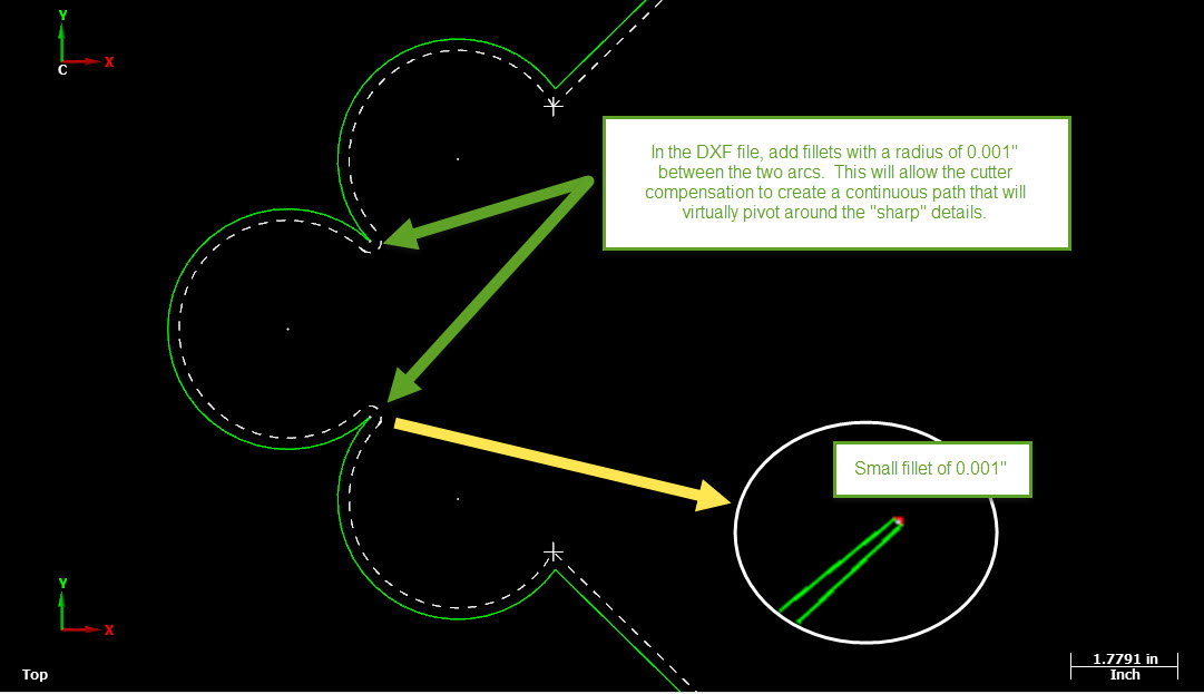

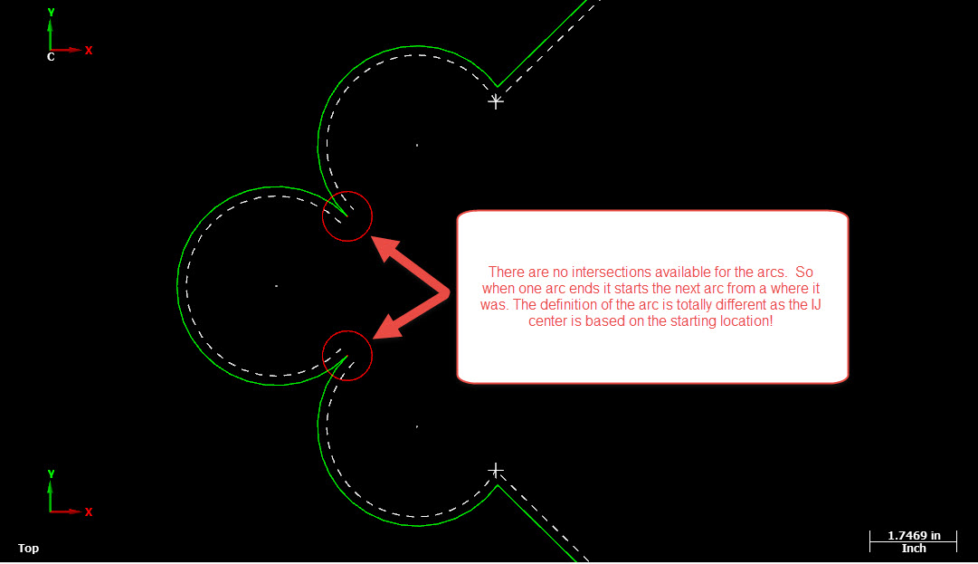

Your issue is because of the lack of arc intersections when cutter compensation is applied. See the images to review the issue and the fix.

Depending on the direction, the first "lobe" was starting out on the correct spot since the straight line and the first arc had an actual intersection during the compensation calculations. Therefore the INCREMENTAL ARC CENTER (defined by the IJ coordinates) correctly defined and "sized" the 1st arc/lobe.
The only thing is, is that since the first arc and second arc did not have an actual intersection in the calculated compensated path, the tool was NOT at the correct starting point for the next arc/lobe. So the INCREMENTAL ARC CENTER, defined an incorrect radius and center point for the next arc/lobe.
Now it appears that since this "wonky" 2nd arc was larger and off center, the resultant calculated compensated path at its endpoint did then produce an intersection with the 3rd "lobe" and therefore that final arc had the correct starting point - resulting in a correctly positioned INCREMENTAL ARC CENTER and properly positioned & sized "lobe".
In today's day of CAD/CAM packages, this situation is usually avoided as the CAM side would either alert one to the issue in advance OR add something to correct it and provide a continuous path.
I would believe that Thermwood's "tolerance" with these non-intersecting entities during cutter compensation is so that in general, when dealing with instances with lots of small line and arc segments, that a small gap would be "smudged" through. (Just a guess though.)
Hopefully my fix got your parts cut...
