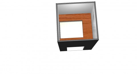

Hi Carmen. The method that you described seems like the quickest and easiest way to get the cabinets in the room and still give the customer a good idea of what the layout will look like. However, if presentation is what you are after. You can draw the walls the same height as the ceiling height, then use a display cube that is the same thickness as the floor, position the cube so that the top is at the same height as the second floor in your room . You can then cut a pocket in the cube for the stair opening. You can also use a display cube to create the stairs. This method is a lot more involved but should give you a very impressive presentation to show your customer. The screen shot is an example of using a cube for the floor. I hope this helps.

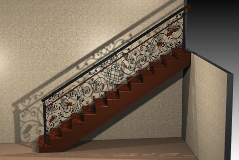

I have this staircase as a Display Object if it would help. It is scalable.

Kerry that would be great. Thank you for offering.

Carmen,
It is on my computer at home. I will send it tonight.

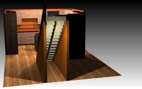

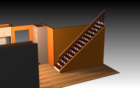

Here is a link to another thread that has a downloadable .stl for a staircase. You'll have to load each piece into the Display Part Editor and modify textures for each piece.
http://www.thermwood.com/forums/viewtop ... irs#p63939
Here's a couple pictures of the staircase that I used.

Here is the stair display part.
