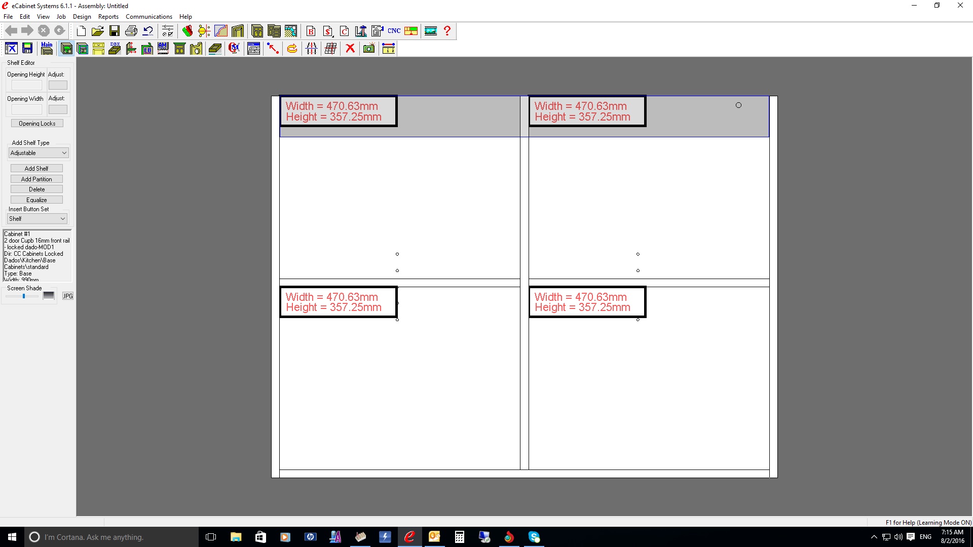

Wanting to use the back shelf pin hole feature with a partition, I can only get holes on the left side of the back??
Am I doing something wrong?

Not sure how to add photos. Just build an upper framed cabinet add a Partition, add an adjustable shelf on the left side of the partition then add an adjustable shelf on the right side of the partition... For me I get the back holes for the left side shelf but not for the shelf on the right side.
Hope that makes sense.

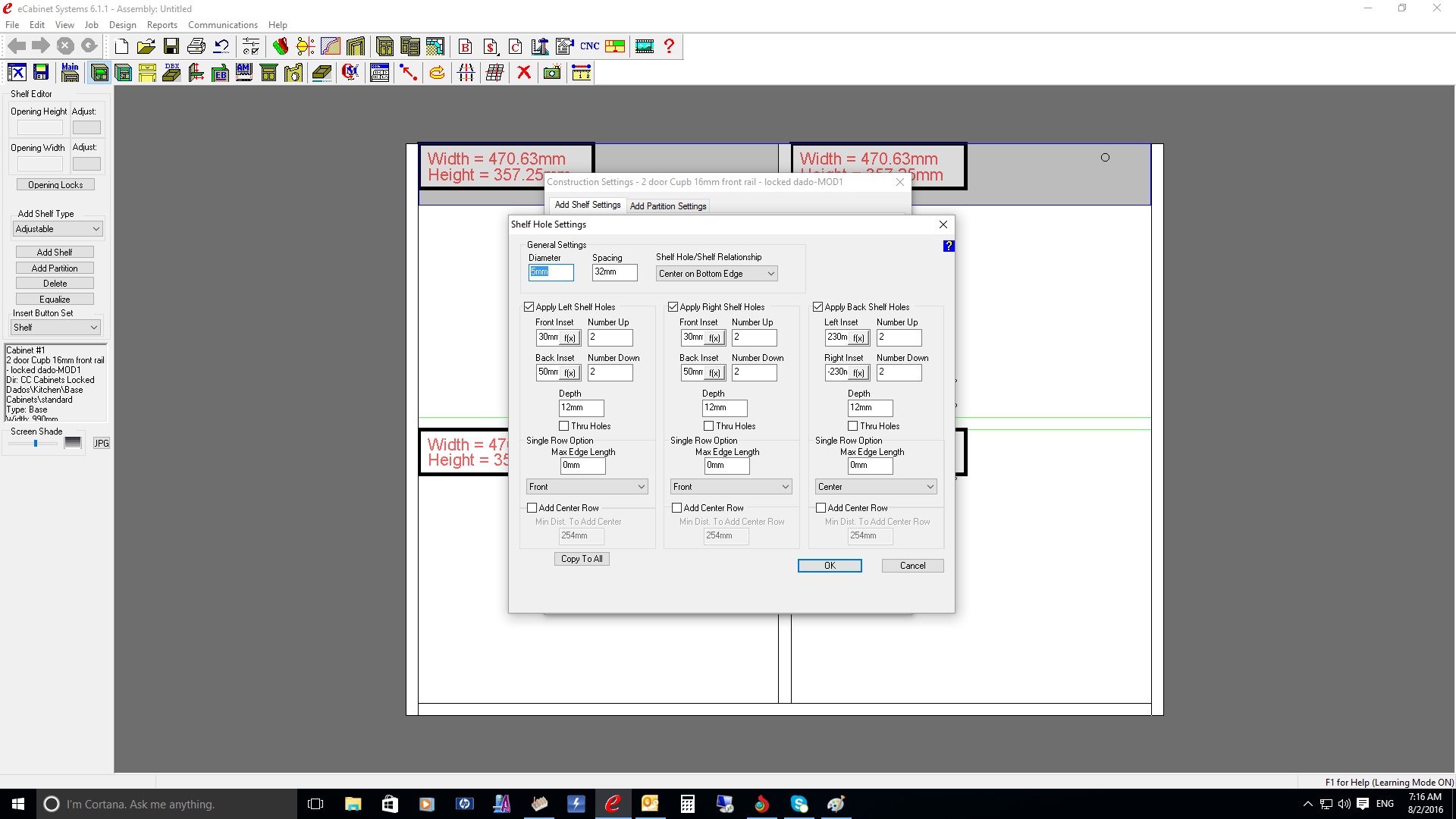

i have duplicated the issue your having. from what i can see you have set so has a single row of holes instead of one on the left or right.
could you set the left margin to be the centre of the left side of partition and same for the rightbut negative number?
seems as if even though there is a partition the settings dont allow for the shelf settings for either side of the partition to be individual

I just took the back to the part editor then to contour ed. highlighted the existing holes copied and moved them to the other side. Back to the Part ed. and cut them 3/8" deep.
Thermwood's team is working on this problem now.
