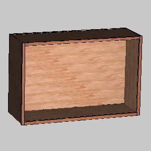

I'm trying to add a false back to a cabinet to create a void that stereo cables can be hidden in. I am using stretcher editor to add a 1/4" piece of plywood to create the false back. I have stated I want full dados on top, bottom, left and right. I am using a left-right stretcher, rotated 90*. I am getting the full dados cut in the top and the bottom but no dados cut in the left or right side.
Is there something I'm doing wrong to not get the dados cut in the left and right side? Something I'm not putting a checkmark next to?
Cabinet attached.
Thank you!!
Bug in stretcher editor?

hi donald,
i have opened you cabinet and i can see what has happened. i couldnt get it to work on that cabinet.
however, i started a new cabinet and checked and changed the settings before putting in the stretcher.
mine has now got full dado left, right, top and bottom. so may be try designing that cabinet again?
i think there is a glitch there somewhere but for now if you redesign and it works for you the second time its a way around that problem
until they can get it fixed.

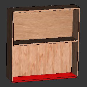

Stuart Douglas
- Posts: 177
Re: Bug in stretcher editor?
Definitely a glitch in the editor. Something to do with the order in which setting are changed. I took a previously designed cabinet, eliminated the partitions due to the reduced cabinet width ( and thus had to redo the fixed shelves), then added the fixed shelves back in. The phantom "stretcher" that is my back, no longer has a top edge where joinery can be changed. It always shows the butt. I have changed the settings in the menu first, and have tried to change the individual part, all of course in the appropriate editor. No dice. I'll redesign from scratch and see if it fixes the problem.

Stuart,Stuart Douglas wrote:Definitely a glitch in the editor. Something to do with the order in which setting are changed. I took a previously designed cabinet, eliminated the partitions due to the reduced cabinet width ( and thus had to redo the fixed shelves), then added the fixed shelves back in. The phantom "stretcher" that is my back, no longer has a top edge where joinery can be changed. It always shows the butt. I have changed the settings in the menu first, and have tried to change the individual part, all of course in the appropriate editor. No dice. I'll redesign from scratch and see if it fixes the problem.
When I open your cabinet, the stretcher to the top has a negative inset value. They create an interference so it doesn't create a dado. That being said, can you give me exact steps you are taking to get a cabinet to do this? I assume you are not modifying the stretcher to have a negative inset value. Without exact steps and repeatability we can't correct an issue.

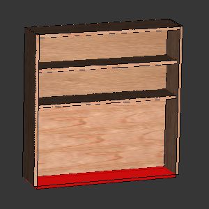

Stuart Douglas
- Posts: 177
My scratch cabinet does the same thing. If I go to the stretcher editor, set parameters and construction settings, everything looks good. I add and adjust my stretcher, and the joinery for the top edge displays an overlapping butt joint. If I check the editors construction settings, everything is just as I have designed it. If I right click on the part and check construction settings, it shows the top edge joinery as butt. If I highlight the part, then click on the construction settings in the toolbar it again shows the butt joinery. I have tried changing all three of these settings and I cannot get it to go to any joinery other than butt.
I did put a negative inset value in to try to get it to make the joinery. I couldn't get it to work with a zero value so i changed it to try and make the rabbet. Maybe the top is trying to do something with the reduced height back that is interfering with the stretcher?

Stuart Douglas
- Posts: 177
AHHHHH, you are right, there is something about the inset that interferes with the changing of the joinery on that edge. If I changed the negative inset back to 0 THEN change the joinery, it is allowed to change. Thanks for helping me thru that!
